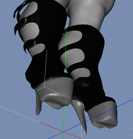

I have Genesis. Now I fit and transfer a bodysuit to it (different polystructure around the foot). Now it has all the bones from Genesis. Now I select the suit and then choose the V4 shoes, and It fits perfectly in preview before the "what figure was it originally designed for" menu appears. But it cannot be applied because it is not a supported item when the menu appears, only Genesis is. So you have to cancel the fitting process. Is it possible to have your clothing items that have been applied to Genesis populated in that list? If so then the shoes can be applied to that instead of Genesis and will wrap around its poly structure. They have Genesis bone structure already since it has been fitted to it, so if the shoes can be applied to a clothing item where the polygons are smooth around the foot IE a bodysuit, then that will solve the issue. But since it can only be applied to Genesis, its a no go. Any thoughts? Will this work if it could be done? It must be done here because the shoes snap into place.

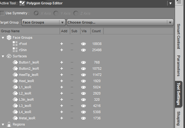

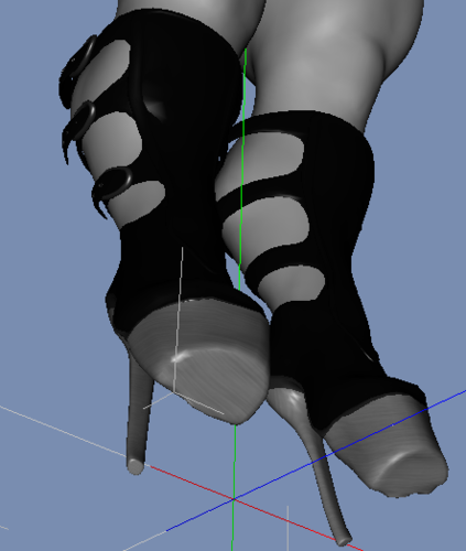

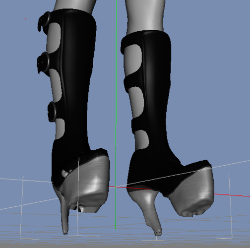

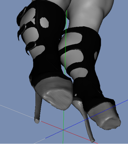

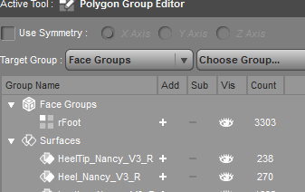

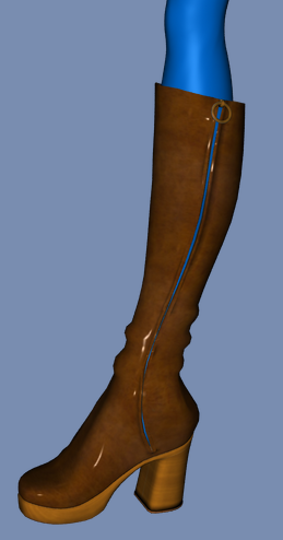

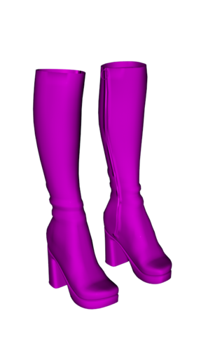

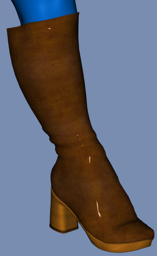

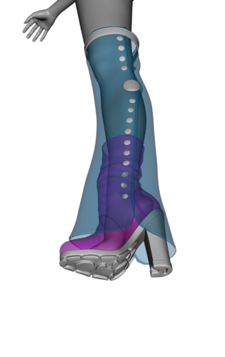

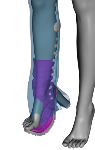

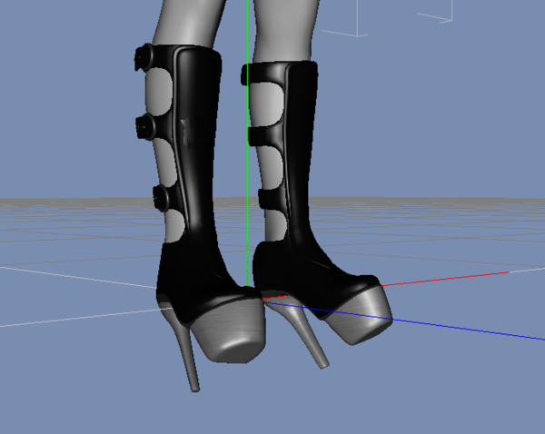

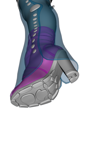

    I tried niccipb's conversion with free nancy boot for V3. First image is the v3 boot, second is the direct autofit to genesis, third and fourth are the conversion boot+ smooth+push autofited to genesis with extreme toon foot, amy and chibi girl. Only big big toe of chibi boy was a problem for this conversion.
    Curiously, this boot have only one face group defined for right side: "rfoot" , no rtoes, no rleg face group as you can see in the fifth image. I had totally successful and fast conversion with two heeled boot, in both cases only rfoot face group is defined. In another case, conversion had several problems, and it wasn't satisfactory.

    That's weird that that happened, but it looks like you did get a nice-looking result out of it.
  • almahiedraalmahiedra Posts: 1,374
    I will try with another shoes, with single and multiple face group to see if this is a consistent statement, or only a casual event.
  • niccipbniccipb Posts: 483
    Hi gilikshe...
    Those boots turned out very nice...
    That is indeed very odd that there is only a single face group. The Figure Setup pane should read all of the face groups that are defined in the original .obj and should not affect them in the created figure.
    If you used the Transfer Utility to transfer the weight maps, this to should not affect the face groups.
    There were bugs in 4.5 with the Figure Setup tools that could cause a crash when adding geometry to the skeleton and some in the Transfer Utility that had to do with projection, but I don't know if that has anything to do with this though as I haven't had that or what you encountered happen.
    Let us (me) know how your other conversions go...
    nicci... :)

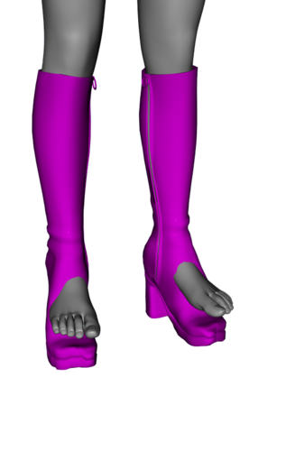

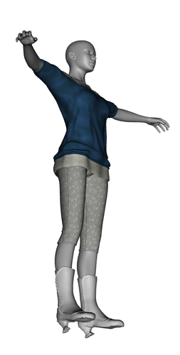

    So, here are some V4 boots run through autofit to V4 Genesis. No, they aren't perfect. The soles are slightly crumpled. The soles of the heels are slightly crumpled. But other than that, the fit is as good or better than a direct load onto V4.
    I can work with this, At worst, most of the problem would be easy enough to shoot around by a bit of care in posing, and the rest would probably be fixable in post.
    Will be interesting to see whether some of the other shoes from this artist are as well behaved.

    Not bad at all. Especially since they're an adorable boot.
