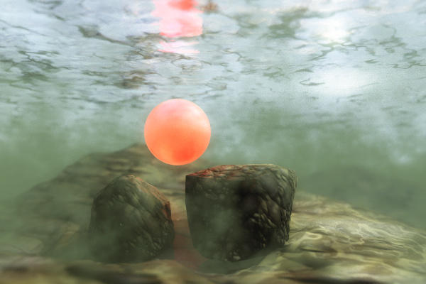

  • Dave SavageDave Savage Posts: 2,433

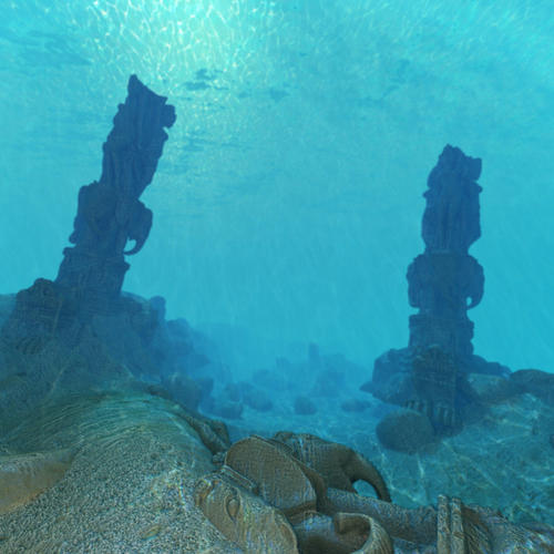

    This is the only underwater render I've ever done.
    I used volumetric material for the water, render time; long. :)
    500 x 300 - 123K

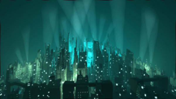

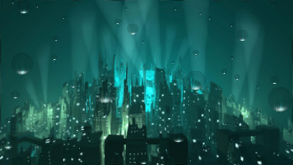

  • David BrinnenDavid Brinnen Posts: 3,136
    850 x 478 - 160K
  • HoroHoro Posts: 11,585
    Very nice scene, David. To me, it looks rather like a city at dusk or at night with a lot of haze or pollution in the air. Perhaps because the lights stream upwards. I like the scene but I don't get the underwater feeling.

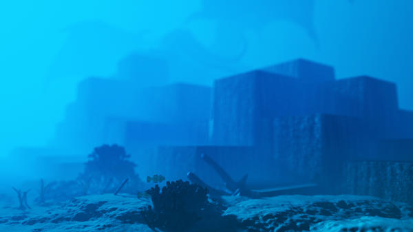

    Hmn... see what you mean. Maybe the image needs more degradation (and possibly fish). I'll try degradation first. Here it is blurred and rippled in PSP8. Better?

  • frank0314frank0314 Posts: 14,915
    edited October 2012
    I think it looks good. Maybe add some bubbles.
    Well... since we are going postwork crazy...
    850 x 478 - 127K
    Yeah, that makes a big difference.
    Thanks Frank! I just hope the "Bryce fundamentalists" don't decide to track me down and skin me alive for using postwork. Shhhh... don't let them know.
    Nothing wrong with a tad of postwork.
    It's a cool image. If the city was a bit further back in the scene, then caustics on the foreground sea floor would increase the idea of underwater.

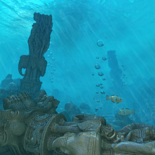

    edited October 2012
    Jamahoney said:
    I hate to burst David's bubble (ahem...'nuff said :), but I don't get an underwater city feel to any of them.
    Depending upon depth, of course, I wonder would putting more light at the top of the edge of the image that then decreases towards darker light (yes, an 'oxymoron') work? Or, another effect, would putting in something like minute, semi-transparent wavy patterns (vertically, like one sees in gas fumes etc., ) across portions of the image work? Or would they work horizontally, too?
    I've only ever seen one or two good underwater artworks, so they can be a bit 'picky' to get right.
    Jay
    Edit: Yeah, postwork is always an easy escape for all of us, but I like trying to avoid it (not always, mind) using Bryce, as it's quite a good practice to push its limits that little bit further, when one can. Said, he...like he knows what he's talking about - being a Bryce noob :)

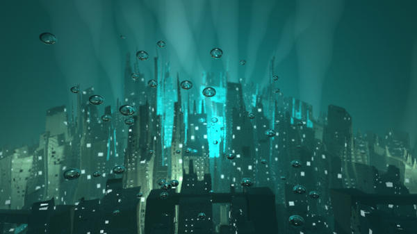

    Perfectly valid observations. Underwater is very tricky... I might have said that. OK, here's a further modification of the idea.
    Bryce 10 minute scene - underwater city effect - made even more underwatery - by David Brinnen
    850 x 478 - 160K
    Post edited by David Brinnen on
    I'm still not convinced. This one convinced me http://nibor.horo.ch/rr14/h14-02.html though it needs more city and less landscape, perhaps no "ceiling", no plants. The bubbles look good but where do they come from? They seem huge - or are near the camera.
    I am beginning to suspect that more visual clues are needed, so cutting out the ceiling or the plants would detract from the impression of being underwater. Given the earlier explanation form PJF regarding "dry for wet", it suggests to me that underwater scenes have to be "sold" to their audience. Since "dry for wet" does not rely on the optical properties of water being substantially different from air. Filters and fog. I don't know. I'll come back to this later on, busy week ahead, so probably next weekend. Including fish or a sub with lights...

    @David: I've looked through glasses of Seven-Up before and have seen bubbles exactly like the ones in the image. I would think, remembering how bubbles look from programs videoed from underwater, there should be more of a break-up to the bubbles as they rise. Like each bubble has several children huddled around them. I don't really get an in the water feel from this image.

    Fantastic work, David. Am constantly in admiration of your Bryce knowledge, and intelligent use thereof, to rapidly develop convincing techniques.
    I can see what the others are saying about the lack of underywateryness, but I think you're very much on the right track and it's just early days. Besides, you are trying to achieve the look of Rapture rather than textbook undersea, and Rapture can be quite unreal looking too, at times. The big ripples and big bubbles are taking things in the wrong direction though, I feel.
    You are correct about the "selling" of the scene to the audience. For the puppet show "Stingray", the underwater shots were made on a normal model stage with a very thin aquarium in front of the camera to provide live fish and bubbles. For the unsophisticated junior audience of the 1960s, it was enough. "The Hunt for Red October" was done "dry for wet", as was the aforementioned "Abyss". Interestingly, "Das Boot" effects were shot in a tank but they still clouded up the water to increase the apparent scale.
    Frustratingly, I was working again this weekend. Really wanted to take a crack at this too. Mind you, at my pace I'd have only managed three bubbles and half a halibut.

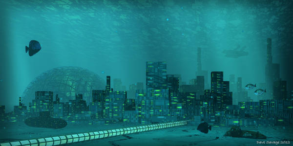

    OK I had a go too... not sure what to think, it was all a bit rushed really.
    1000 x 500 - 142K
    @TheSavage64 - your scene convinces me. It does look underwater to me. It's just that the picture frame is dark, which would be a minor thing to correct.
    Bubbles - don't forget the Particle Emitter, see video http://www.youtube.com/watch?v=W-XVYh4O-hk - Bubbles are the perfect application.
  • GussNemoGussNemo Posts: 1,855
    edited October 2012
    @Dave: I like the scene, it does have an underwater look to it. Like the first image you posted. But have a question. I like the hazy look of the dome and background buildings, but shouldn't the foreground buildings be as hazy as the sub(?) on the left? I would also think the transport tube(?) would have a hazy appearance until it came closer to the viewer.
    Post edited by GussNemo on
    GussNemo said:
    @Dave: I like the scene, it does have an underwater look to it. Like the first image you posted. But have a question. I like the hazy look of the dome and background buildings, but shouldn't the foreground buildings be as hazy and the sub(?) on the left? I would also think the transport tube(?) would have a hazy appearance until it came closer to the viewer.
    I don't think so because it depends on the murkiness of the water and the size of the scene.

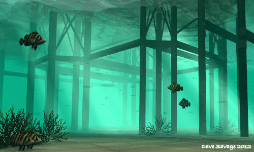

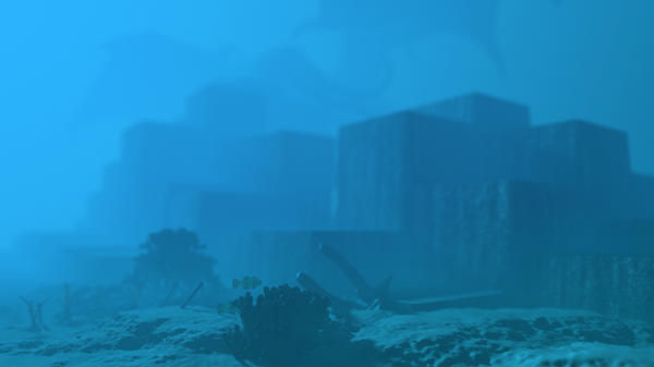

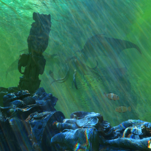

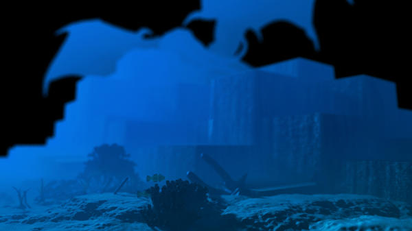

    OK. I've been having a bit of a tinker with this and a think. Thank you PJF for your kind remarks and comments, Dave for the example provided and the further prompting, mostly from Horo.
    So... I've been using google images and having a bit of a look at real underwater images. What is most striking is perhaps the almost total absence of red and, by contrast the over saturation of blues and greens. Also, it seems that underwater world DOF is very strong. I don't know if this is down to some optical property of the water or the lenses used for underwater photography or some combination of the two. But I've noted that many underwater photo's look like miniaturised scenes. Something I usually try to avoid in my renders, but in this case, it is genuine. Finally, most underwater scenes are lost in murky blueness after quite a short distance - the chances of observing an entire city seem to be slim. So with this in mind I've had a bit of a play.
    1 - the Bryce render - you may note there is a lurking presence http://www.daz3d.com/shop/cthulhu-rising
    2 - I used "hardlight" in PSP8 recombining the image with itself to boost the colour saturation.
    3 - having a bit of fun with a distance mask to create a design effect.
    889 x 500 - 117K
    889 x 500 - 122K
    889 x 500 - 100K

    @David: I think the first render is the direction to go for underwater scenes. Especially with structures. Though I know what's being done, there isn't that total feeling that this is an image of something underwater. I've seen foggy days that give similar affects. Perhaps not the color, but the murkiness.
    But at least fog does not make things go out of focus! I think to find some way of introducing some intervening layers of suspended murk may help? If I have time later...
    @David: No, I think you've got the murk correct. What's missing is the variation of light that would be coming from the surface due to wave action. If you look into a swimming pool on a bright sunny day, you will see how the light motion of the surface causes different patterns on the bottom of the pool.
    This same thing is going to happen in the ocean, but not to the same intensity as a clean pool. If you watch any programs filmed underwater, there are rays(?) always present if its been filmed during bright sunny days. It's like the light is dancing underwater. To me, that's whats missing in your latest render.
