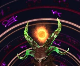

    An example of what I am trying to do is to take the Sabbatic Goat's horns which are quite grooved through bump and displacement maps and get them to reflect light as though they had had gold polishing/gilding so the underlying colours and textures would still be there but the grooves (or their peaks, rather) would catch and reflect light.
    I am getting something vaguely approximating the effect using pweffect on a geometric shell over the horns but it is hardly very subtle and will probably need a bit of work to make it how I am wanting:
