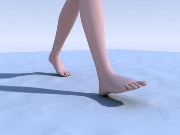

    There was another discussion a short while ago about animating a figure with a static IR map. and I used the saved IR map trick to actually render a GI scene in a very reasonable amount of time. You can fly a camera around your scene as much as you want with a static map, but if you animate a figure or change the lighting, you'll have issues. You can't save an animated IR map, which is a bummer.
    https://www.youtube.com/watch?v=cLHnOrEyz3Y

    According to the manual the IR map is the complete scene, so as long as there aren't animated objects or lights you can render the scene from any angle without having to redo the map. The manual says you could even animate a camera moving through the scene.
    I don't know what an aspect change would do to the map. I haven't tested it. I usually just have proportions locked and reduce the scene resolution.
    The video I linked to showing the artifacts caused by an animated walk cycle in a static map was rendered at 240X180 to generate the map, but then the finished the video was rendered at 640 X 480. First frame no artifacts.

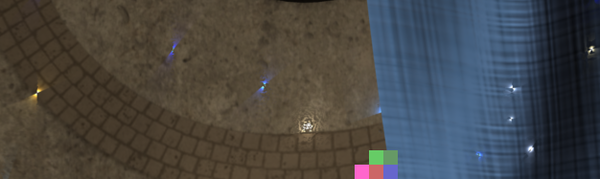

    There are some limits to this. I just did a check, hoping to reduce the render time of a particular scene. The scene is to be rendered at 3200x2400 so I reduced to 320x240, saved the irradiance map, then set to use the map changed the render resolution back to 3200x2400 and got numerous artifacts. I cancelled the render, but I've attached a clip to show some of the problems.
    626 x 187 - 141K
    That's good to know about a limit. Are the artifacts the light effects or in the shadows? When you rendered the initial sample image, what was the lighting quality, photon count and map accuracy set to? I noticed that when using a saved map those options are disabled in the renderer.
    All the light blooms are erroneous. Mostly white, but I see four in the sample that are blue. The GI settings were defaults (I don't recall just what those values are). This particular scene takes a ridiculously long time to render (~20 days on my system) so I did drop not only the resolution but also the antialiasing, object accuracy and shadow accuracy (none, 4 pixels, 4 pixels). My normal settings are good, 1 pixel and 2 pixels. No other settings changed -- maybe the antialiasing or accuracy setting changes are responsible?
    I put them back to what I used for creating the irradiance map and am trying again.
    edited to add: I've checked "Use saved Map" and selected the saved irradiance map, but none of the settings are ghosted so it at least looks like I could change them.
    edited again to say: it *has* been two years since I last touched this scene so I was assuming that it would render correctly at all -- but for all I know the current build has an issue. Although I could tweak things to improve the render time, this is a nasty image to render with refracted light passing through multiple planes and a large number of hairs (currently rendering so I can't get a count, but hundreds of thousands at the least I'm sure) with respectable segment count (can't check, but I'm pretty sure it was high to keep them as smooth and natural as possible).
