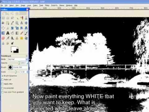

    ok after viewing more vids I think I'm beginning to catch on....the first step is to remove everything but the shadows on the one image ....what method of doing this is the best for this purpose?...it seems as if every vid I 've looked at uses a different tool.
    Ah, I see what you are trying to do. Render another image with no backgroud. Then paste the no background image on top of the other and then select the car and go to Filters > lighting and shadows > perspective and you can then create a shadow based on the car figure shape.
  • 3DthiSS3DthiSS Posts: 146
    I have an image rendered in "Statue" mode where I have to somehow separate the shadows form the car and then merge this with the "real" render....so do I simply cut out everything but the shadow in the front of the car or do I use something like a layer mask as is shown in this utube vid?
