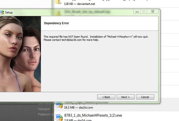

I am trying to load the M4 Morphs++ into Poser 2010. i get the message on the attached image.
I cant find a Poser.exe file. Any ideas as to what to do?
Obviously. i am new to this stuff so go easy on me.
Richard

  • Richard HaseltineRichard Haseltine Posts: 112,089
    Select DAZ Studio as the target application, then install to the folder you selected as your Poser content library (the folder that holds the Runtime folder) - that won't usually be the application folder.

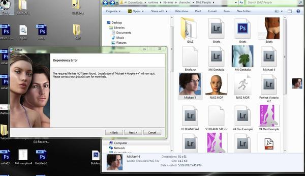

  • richard_13f62021bbrichard_13f62021bb Posts: 12
    did not work. see attachments.
    also tried runtime folder within the Downloads folder. that did not work either.
    thanks,
    richard
    does this help? where in here would you put it?
    richard

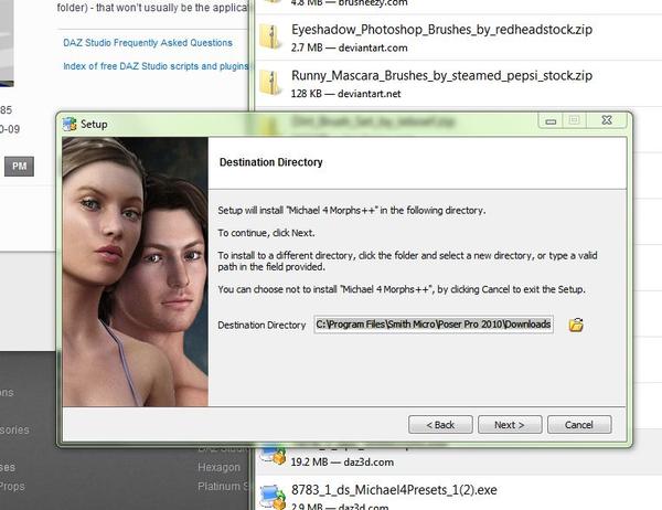

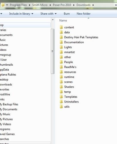

    no that did not work. see attached. is this file not where the M4 base is?
    am i still supposed to target DAZ Studios and not Poser? (i tried both..did not work)
    thanks,
    richard
    1278 x 737 - 135K
  • fixmypcmikefixmypcmike Posts: 19,743
    Ah, you're using Windows 7 or Vista. Putting content inside the Program Files hierarchy will not work, as the operating system protects those folders, so the files aren't really there. You need to move your content outside of Program Files.

    User content should NEVER be installed into the Program Files area in Windows 7 or Vista.
    This has nothing at all to do with DAZ 3D, but Program Files is a protected area. When an application tries to write anything there, it is sent of to a 'Roaming' folder. DAZ Studio content or Poser content will not work properly is stored in Program Files, so it is a very good idea to move it as soon as possible.
    The recommended place to install user content is in the Documents area, but any other folder will do, as long as it is not inside the Program Files folder.
    Did you previously have an XP computer, and copied the whole runtime folder over on your new computer? Any morph packs you installed under XP would probably still work, but new morph packs probably won't.
    PP2010 defaults to putting content under Documents, but it can be anywhere as long as it is not a protected folder. You don't need to reinstall Poser, just move what's under the Downloads folder into a new location.
    edited October 2012
    First of all, where did you install M4 into?
    Michael 4 is in Poser format, so you should install the Poser files for it, the ones with DPC in the filename. If you are only using Poser, you do not need the files marked DS at all.
    The best way out of this I think, is for you to reinstall M4 into your Poser runtime where it is now. It should be installed into the folder which 'Holds' the Runtime folder. Only install the files that have DPC in the filename.
    Then the Morphs++ file will install if you select DAZ Studio as the target application. The installer will not then look for a file called 'Poser.exe' whcih you wont have anyway.
    How V4 and V4 Morphs++ work in your current setup I don;t know, but storing user content in the Program Files area is not a good idea if you are using Win 7 or Vista (are you?)
