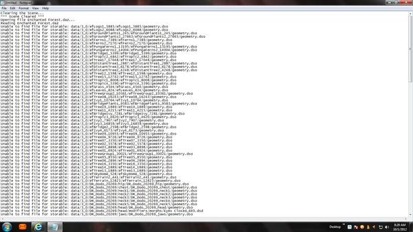

  • VitachickVitachick Posts: 135
    Here is the log
    1600 x 900 - 616K

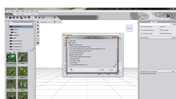

    I also have Daz and Poser on an external drive. This is where I load
    all new items...Do this to save disc space on main drive As you can see
    Enchanted Forest is listed on left...I just cannot save and reopen it.

  • fixmypcmikefixmypcmike Posts: 19,738
    The problem is that your first DS-format content folder is under Program Files. Win7 protects that folder, so the data files aren't really being saved there. but instead in an Appdata folder.
  • JaderailJaderail Posts: 0
    Good catch!! Never noticed, nor have I seen a Programs folder on an extra drive before. Emergency Boot drive type thing?
    edited October 2012
    With your current Content folder settings you will be able to READ (load) all your old Scene files just fine. But Any NEW Scene files you make will not get the needed DATA files written to the Content/Data folder. Win7 protects the Progam Files folders from writes except at Install and paste into times. What you can do is just COPY your DAZ3/Content folder from inside Program Files and then place it any place you like. Then point DS to the new location. When you do (if you do) I would also move it to the top of the list once again. The Top folder is the one DATA will be saved to, it can be read from any but saves to the top Directory listed as a DS folder.
    I said Copy so you can Test it before you remove it. You will also need to remove the Top folder from your Directory list BEFORE you add the moved version.
    You will also need to keep a note on the new PATH to your content folder so you Install new content to the proper place.
    TIP: XP does not protect that area of your drive. That is why DS3 worked just find in XP.
    Post edited by Jaderail on
