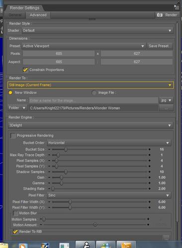

  • Knight22179Knight22179 Posts: 1,195
    Here you go.
    549 x 751 - 69K
  • fixmypcmikefixmypcmike Posts: 19,738
    Reduce the shading rate -- I use 0.2 for final, .5-1 for draft.

    With shading rate 2.00 is low quality and .20 and lower are high quality settings.
    UberEnviroment which your lights work with also has a shading rate so if the blotchiness is still there then lowering the Uber Shading rate will help further but also increase render times..
