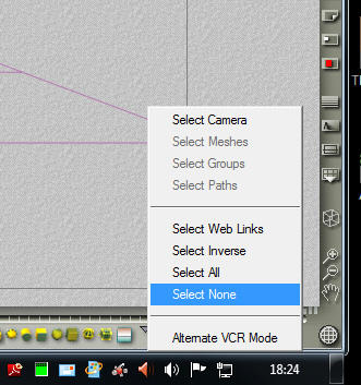

    Image 1 - Launch Bryce.
    Image 2 - Make sure nothing is selected. You do not want to send anything from Bryce to DS that's a really bad idea I've discovered.

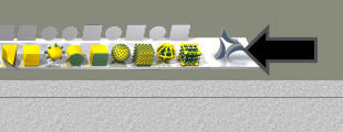

    Image 3 - Hit the button on the create shelf.
