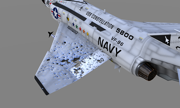

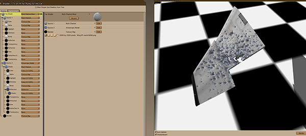

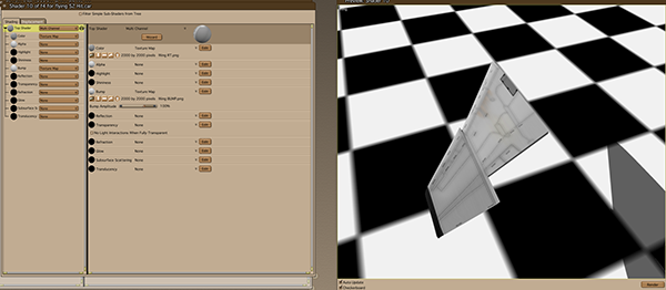

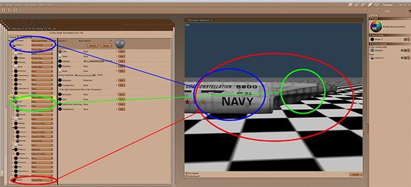

    Okay heres what I got! I want to add some SA2 Missile near hit damage to my F-4! For all the object involved I have 2 copies that I plan to turn on and off at the appropriate time. I want the Rt Wing, Tail, Rudder and Fuselage to all have copy with all the damage…
    On the Rt wing and the 2 ailerons it was easy they only had one SOURCE. The fuselage is another story. it already thad 2 sources as does the rear tail section!
    The FUSE has a TEXTURE map Mixer to let the MEtALIC part of the rear/tail end sort of come through and looks worn and discolored somewhat by heat ext. SO it already HAS a texture map to cover up the PAINT and let the metal pop out!
    I need another that will not only show the paint but not mess up the metal area at the read AND show the new flak damage which consists on a MASK/TEXTURE MAP MIXER… a HOLE MAP to put an ALPHA for the missing metal… and a BUMP map to simulate bent metal ! SEE WING DAMAGE! PIC
    Now the FUSE source 2 uses a metal shader OTHER than the metal shader called ALUMINUM I want to use to show the damage or I could go into the source one and two MASK and modify it.
    PLEASE ADVICE!

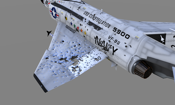

    I DID IT I DID IT and I didn't think it would work! I added another Mulit Layer Mixer to source number 2!!!!! I didnt think it would come through to the top layer but it did!
