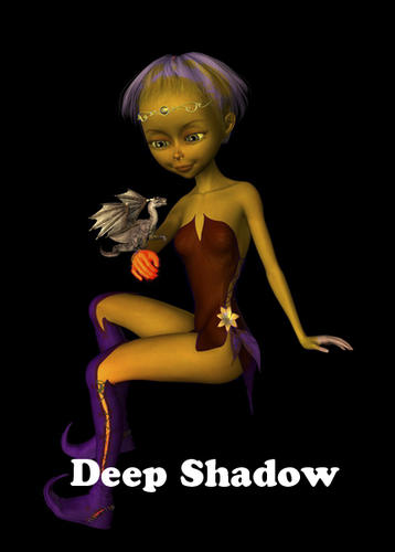

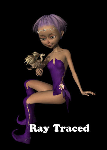

    I have to agree with Scorpio64Dragon. There have been problems with the deep shadow maps for as long as I can remember, especially the artifacts. With DS 4.5, something else has changed (broken) with the shadow maps. The actual texture itself shouldn't matter to a distant light with deep shadow map. Those designed for SSS would simply "look" better when you ray trace or Uber lights.
    See pics below. This is the Bree texture. Ray trace does fine but I don't understand why I get that error and why it renders the way it does when I switch to deep shadow map. It shouldn't matter one way or another. Right?? Or not??
    429 x 600 - 89K
    429 x 600 - 96K

  • RAMWolffRAMWolff Posts: 10,398
    edited September 2012
    WOW.. it's rendering the skin gold like that? Notice the one extended arm, the fingers are normal shaded tint and yet the arm supporting the dragon the hand is even more intensely shaded, like an orange color. ODD!
    Very cute character!
    Yes, and sometimes it's just odd places or the whole body. Sometimes the whole body turns red like her right hand. Well unless anyone has anyone has any ideas about the deep shadow map, guess I'll need to switch to ray tracing or use uber lights.
    Thanks Wolf. That's Mavka for Genesis by Smay.
