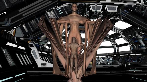

    I am having the same problem, but it's even worse. My figures come back in completely messed up. The load up as some type of "thing" that is very reminisant OF the thing. It's pretty ridiculous.
    So far I am not very impressed with DAZ 4.5. You can't down-save to the .daz format, and half of the .daz files that were saved in 4 either don't open, won't save, or won't load in properly. Once you resave a .daz file to the .duf format, you're screwed.
    I have installed and reinstalled 4.5 about 4 times. I still am having the same issues. As you can see, the figure is not happy about it either!

  • ReDaveReDave Posts: 815
    Just resave your scene a second time.
  • tommyBoyetommyBoye Posts: 0
    Thanks I will give it a try. I ended up rebuilding the scene and that seemed to work as well.

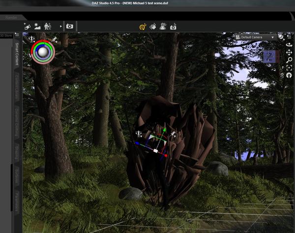

    I am experiencing the same kind of problem. This seems to only show up with Genesis figures from time to time. For example, when I save a scene that includes Michael 5 then load it later, the M5 character is deformed. Please see my attached photo.
    I will continue to test and see if I can determine what is going on. If anyone has any suggestions, please let me know. Thanks!!

    As the person replying to me stated, try re-saving your .duf scene out to itself again by doing an over-write and supposedly the problem will go away. Let us know what happens.
  • KnightTekKnightTek Posts: 68
    The first time I tried re-saving the file again it did not resolve the issue but after re-saving a second time it fixed it. Thanks for your help!
