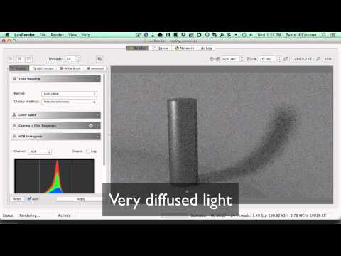

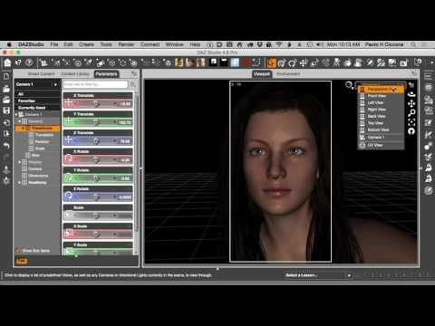

    Let's start with a lighting tip.
    Lighting is 80% of your scene. I'm not kidding. Have a scene with excellent lighting and mediocre textures and you will wow the audience. Use excellent textures with bad lighting and your scene will look bad.
    It follows that we need to be able to control our lights if we want to obtain a good result. Here is a great example of a character that is almost cartoonish but which is enveloped by excellent light, giving us a stunning picture:
    No Angel
    Image by saywhonow, http://www.daz3d.com/gallery/images/130076/
    When it comes to lighting, the Reality Mesh Light is generally the most flattering, flexible light that you can use in your scene. The issue is, it does not emit light in Studio or Poser, because the programs don't provide that feature, and so people often find themselves at odds with the light fixture. They don't see how they can point it effectively. Here is how.
    If we look at the Mesh Light parameters, either in Studio or Poser, we see that there is a Morph group and in there we can find a "Handle Length" parameter. If we increase the value for that parameter the handle of the light will extend as a "laser pointer", showing us exactly where the light will fall:
    Light pointers
    It's that easy. Now you can point the Reality Mesh Light with dead-on accuracy. Couple it with simple shape change, using the Scale parameters and you can get very focused, sculpted lighting. To top it off, use the Snoot control to avoid light spillage. The handle is never renderer so it does not matter if it's visible in the frame.
    You can see all this in action in a video tutorial on YouTube:
    Hope this helps.

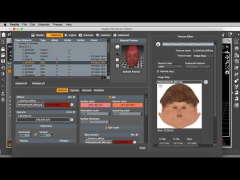

    Henrico, glad that you found the tip useful. Faces are tough, that's why, when I make a preset, I start with the face. If I get that right, then the rest will be easy. I generally create a Camera just for the face, usually with a 180/200mm lens (focal length), and place two mesh lights: one in front and one above. I then go to work. Skin is very reflective, so the specular color needs to be fairly bright, 64:64:64 if you are using a solid color, is a good starting point. If you have a specular map then that's better.
    While the skin is highly reflective, it is not very polished, so the glossiness strength should be failry low. A set of values of 6500H/7000V could be a good starting point. Next I work on the bump map. It has to be strong enough to break the shine of the skin, but not so strong to look like granite. That is something that will generally take some trying because every bump map is different. To make things faster to render I render via the face cam and hide all the other parts of the body. I just keep the face, lips, cornea, iris, sclera e eyelashes visible. Do that by Shify-Clicking on all the materials, hold the shift and then click on the Hidden checkbox. That will hide all materials. Then uncheck the box for the materials that you want to see. That will make exporting and rendering much faster. Once you get the face materials right it's just a matter of using the Sync feature to copy the settings to the rest of the body.
    Here is an example, using the Victoria 7 preset:
    Victoria 7 Preset for Reality
    Hope this helps.

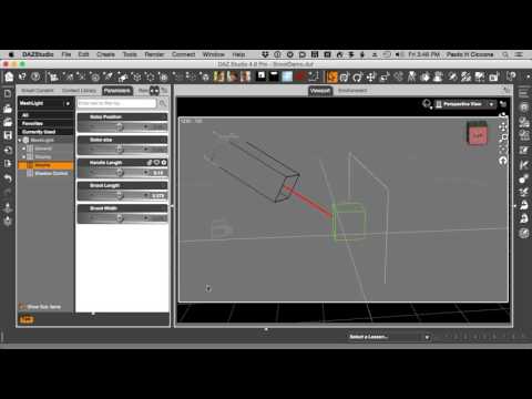

    Since we mentioned the snoot for the Mesh Light, lets' talk about how this feature can be useful. As far as I know, the Reality Mesh Light is the only light fixture that provide a built-in snoot and gobo (more on the Gobo later). These are controls that mimic what we can find on professional-grade photographer's lights.
    Lighting is not about illumination. Lighting is about vision and artistic expression. We are captivated by an image, most of the times, because of the subject, the story, and the lighting. Many times, lighting is what tells the story.
    To get lighting done right we need to control the light. This means to be able to:
    • Position the light
    • Scale/deform the light
    • Control the quality of the light
    • Control the area affected by the light
    The last issue is extremely important. If we place three lights in the scene and they bleed over each other, we might not get the effect that we want. In many cases the bleeding will result in areas of the scene double- or triple-lit, with the result of making it very hard to have the correct exposure throughout the scene. Some parts will be too dark, some parts will be too bright.
    To control the light we need a way of blocking where it goes. This can be achieved by placing black planes, called "flags", in strategic parts of the scene. Another way is to extend the Snoot of the Reality Mesh Light.
    The snoot, as we can see from the image, "boxes" the light inside and prevents it from spilling until the opening is reached. This can be very valuable for artistic lighting and it's a snap to use by dialing the "Snooth Length" parameter in the Morph section, either in Studio or Poser.
    You can see how this works in the following video tutorial:
    When used in conjunction with the Handle Length morph that we saw before, the Snoot can be a very easy, very quick, way of controlling the light. Try it with a few test renderts to get a taste of what it can do for you.
    Cheers.

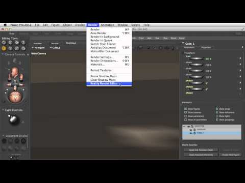

    How to get volumetric effects
    "God rays" or "Spotlight beams" are examples of volumetric effects. In the real world these effects are caused by light following a constrained path and the hitting particles suspended in the air.
    In the case of "God rays" the sun light finds some openings in the clouds and it gets scattered by the atmosphere particles. For a spotlight beam we have a light confined in a canister, the spotlight, exiting the canister and then hitting the dust suspended in the air.
    In 3D, a volume is a special type of material that simulates the particles in the atmosphere. In Reality we create the volume using the Volumes tab. You can find the details in the Reality User's Guide (aka the RUG), included in Reality. See the Help menu.
    Once you create a volume you need to put it somewhere. That is easily done:
    • Placing a 3D oobject of any kind, like a cube, in the scene
    • Change the materials of the object to be of type Null. A Null material keeps the geometry of the object but it paints nothing for each polygon. It makes the object invisible.
    • In each material of the object click on the Volumes tab. This is the tab for the material, not the global Volumes tab at the top of the Reality window.
    • Assign the volume to the Interior part of the material
    Now you have a volume that can scatter light and it has the size, position, and shape of the object that encloses it. If you shine a very narrow, about 7 degrees of spotlight cone, light on that volume, you will get a beam of light in your scene.
    If you use the DAZ Studio cube to try this experiment be aware that that primitive has errors in the geometry. One of the sides has wrong surface normals, pointing inside, instead of outside. The result is that the beam will not be visible. If that's the case simply rotate the cube so that the worng face is resting on the floor.
    You can see a full tutorial on how to make this work here:
    DAZ Studio version
    Poser Version
    Have fun with volumes!
