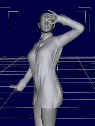

    OK and on a lighter note, here is a clip of the new loose shirt which is still very much a work in progress.
    Thanks for all the help!
    315 x 420 - 30K
