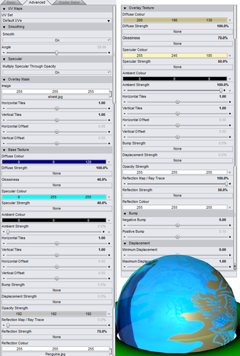

I recently started playing with Shader Mixer. I've just got my first reasonable result (still a WIP though) which uses a mask image to apply one of two alternative textures to the surface. I wanted this for a couple of current projects - shield designs in gold paint on wood/leather, and gold leaf applied to stone carvings.
I had a couple of specific requirements:
- the shader has to work in DS3 as well as DS4 (I know that DS3 Shader Mixer never left beta, and some bricks have changed)
- it has to work in the FREE versions of DS3/DS4 (i.e. all paramaters must be sensibly laid out and adjustable on the 'Surfaces' tab, because users can't open Shader Mixer in the free versions)
- I want the 'Surfaces' tab parameters for each of the two textures (base and overlay) to closely match the normal parameters you'd get if you create a simple primitive (to make it as easy as possible for a user to work out what does what).
I've now got a simple material shader that more-or-less meets this goal. I created it in DS4.5 and exported DBM, DUF and DSA files. The DSA and DBM files seem to work fine in DS3. I can use the shaders in DS4.5 and DS3 without opening Shader Mixer.
There should be two images attached - a zoomed out overview screenshot of shader network, plus a DS4.5 render of a sphere primitive with the shader applied (red torus primitive simply for checking reflection

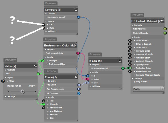

    When you Create > Primitive > Sphere you get two reflection parameters on the surfaces tab:
    - Reflection Color (allowing you to set image and/or colour - default no image, white)
    - Reflection Strength (allowing you to set image and/or value - default no image, 0)
    If you set reflection strength to non-zero, and there is NO 'Reflection Color' image, then the renderer uses ray-tracing.
    If you set reflection strength to non-zero, and there IS a 'Reflection Color' image, then the renderer uses that as an environment map.
    With Shader Mixer it's easy to do ray-traced reflections and/or environment-mapped reflections, but is there a way to automatically switch between them using the same criteria? I.e. can anybody suggest what I should plug into the inputs marked '?' on the attached image?
    587 x 429 - 49K

    Question 2:
    No bloody idea...that's something that's been driving me nuts. I can't figure out how the 'automatic' part is done. For my stuff, I just leave it alone an make it manual.

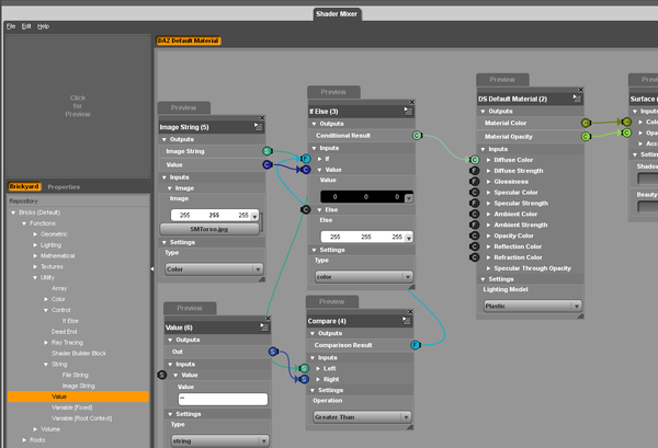

  • ReDaveReDave Posts: 815
    I tried the attached network but it doesn't work. It always defaults to the non-string colour. :-S Plus, it would work in DS4 only.
    You're right, it doesn't!
    I hadn't thought of using image strings before - just tried all manner of variations of what you did, with the same result as you.
    It seems fairly clear from what I just tried that the compare brick works with float or colour inputs, but not string inputs. Checked the Compare Brick Documentation - still draft WIP as expected
    (not complaining - if everything was documented I wouldn't be having all this fun! :cheese: )
    (Hmmm... here's a Heath-Robinsonish idea that might sort-of work (in DS3 too maybe): the colour output from an image map brick will be a fixed value if no image is selected, yes? So if you could compare the actual output with that fixed colour... )

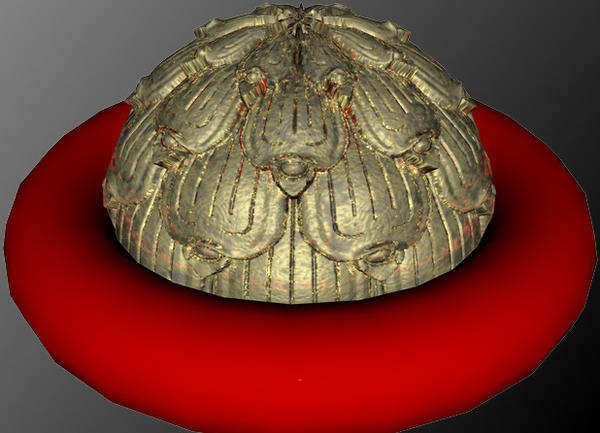

    P.S. I did a render in the free version of DS3 (attached) just to confirm I'm on target for that goal. I used a very different overlay mask image this time (sort of cloudy-patchy) - I think it's quite a nice effect.

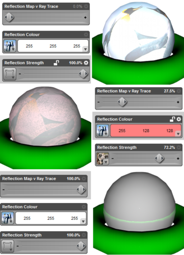

    Re Q2 (Reflection): Now have a work-around - one extra control on the Surfaces tab
    I couldn't get that idea to work - no way to get at the fixed colour of the image map brick, or to feed a fixed colour to it!
    Couldn't find any on/off switch either. However, a slider to control the balance between reflection mapped / ray-traced reflections seems to work.
    I'm assuming that when the 'Reflection Map v Ray Trace' slider is set to zero, then the rendering software will completely ignore the Trace brick, since the Alpha i/p to the Mix brick tells it to use all base, no layer. Am I correct?
    Attached: network screenshot, plus example renders with the Surface tab paramaeter settings.
    (P.S. Rob [rbtwhiz] mentioned that there was a reflection bug in DS 4.5, but I found that setting Sample cone, max dist, samples and bias all to +1 gave me reflections!)

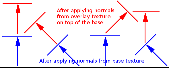

    Question 3: What's the correct way to combine two normal maps, and how do I do it in Shader Mixer?
    Vector addition is definitely the wrong maths to use on normals (hopefully the attached sketch shows why*).
    Assuming I can work out the correct method for combining the vectors (my maths is rusty), then plugging the result into a Value (Normal) brick seems to scale it back up/down to a unit vector correctly.
    Of course, the normal map colour value that produces a flat surface is (RGB) 128/128/255, not black or white. But ideally I want to disconnect the whole normals calculation network if no normal map is selected, so failing some flash of insight it looks like another slider (although only 'on' or 'off' make sense for normals - how could you apply a percentage of a normal map? Doesn't make any sense!)
    Found a useful video on Vimeo here - Photoshop - Combine Normal Maps. Covers the subject in a non-mathy way. Now how can I apply that to the normals in my shader network? (Looks like red and green components [can't recall RGB to xyz correlation] should be combined in the same way [adding?], and blue components in a different way [multiplying?]. But I can't get the maths to add up)
    *Sketch needs a few words:
    Left to right, base normal values (blue): 0, -45, 0, -45
    Left to right, overlay normals (red): 0, 0, +45, +45
    (0 is straight up from surface, -45 is 45 degrees anticlockwise, +45 is 45 degrees clockwise)
    589 x 238 - 13K

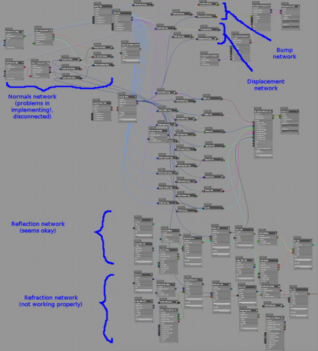

    No breakthrough - still can't get normals and refraction working properly.
    Beta uploaded - see this Freepository thread if you're interested.
    Re combining normal maps - simply adding red channels, adding green channels and multiplying blue channels seem to be the accepted way to do it. Splitting the normal maps into RGB (xyz) with a Component brick and doing the necessary maths on each component seems to work, but I can't see how to combine the three results back into a vector. (also the Component brick seems to be DS4 only)
    Refraction - no idea what's up there. Index Of Refraction seems to have no effect on ray-traced refraction. Maybe setting sample cone, max distance, samples and gain all to +1 (which seemed to get ray-traced reflections working) doesn't work here? Maybe it's a DS bug?
    Here's a really zoomed out overview of the whole network as it stands for the beta - DS4.5 Shader Mixer screenshot (well 2 screenshots combined - can't zoom out below 30% and I'm on my laptop)

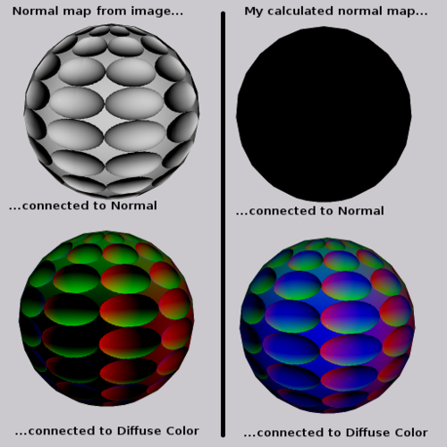

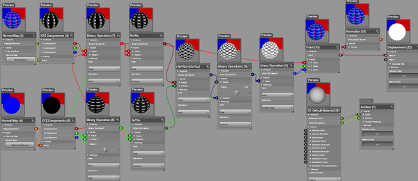

    Very simple normals network here. From the Shader Mixer brick Preview renders it looks like it should work. But if I apply it to a sphere primitive and render, the sphere is rendered plain black! The maths is really simple (suffixes - b for Base Texture, o for Overlay Texture, c for combined - Bc is calculated as the value that, combined with Rc and Gc, will produce a unit vector (Bb and Bo are ignored)
    Rc = Rb + Ro
    Gc = Gb + Go
    Bc = SQRT( 1 - ((Rc*Rc)+(Gc*Gc))
    If I connect the outputs from the 'XYZ Component (5)' brick [top left] to the inputs of the 'Point (13)' brick [top right], apply, and render it works fine, so it's defintely something wrong inbetween...
    Any ideas?
    (P.S. The 'Normalize (21)' brick appears to have no effect, which is what I'd expect since I've calculated a unit vector already.

    Although the brick preview renders of the 'Normal Map (3)' and 'Point (13)' bricks in the network of the previous post look the same to me, it's clear from the four renders in the attached image here that the outputs of those two bricks are very different:
    Top left - 'Normal Map (3)' output connected to 'Displacement (22)' 'New N' input.
    Top left - 'Point (13)' output connected to 'Displacement (22)' 'New N' input.
    Bottom left - 'Normal Map (3)' output connected to 'DS Default Material (2)' 'Diffuce Color' input.
    Bottom tight - 'Point (13)' output connected to 'DS Default Material (2)' 'Diffuce Color' input.
    Can anybody explain this?
    Sounds like DS uses the other kind of Normal Maps (I don't remember what they're called specifically), the ones in which the blue channel does have an effect. Try reducing its intensity.
    Or perhaps it guesses it is the other kind of Normal map if blue values are different from zero?
  • 3dcheapskate3dcheapskate Posts: 2,567
    Thanks ReDave. I don't think it's the type of normal map that's the problem (though I may still be proven wrong). I create all my normal maps in Blender 2.49 using the 'tangent' option (the other options being normal space, world, object, and camera). These Blender-generated normal maps seem to work fine in DAZ Studio. (I'm fairly certain that the red and/or green channels need to be inverted and/or swapped over - something I haven't done - but I'm 99% certain that has nothing to do with what I'm seeing here).
    I've been trying all sorts of things, and I have to admit I'm at a total loss now. The problems come down to this:
    - A single normal map in a 4-brick network works fine: Normal Map -> XYZ Components -> Point -> Displacement).
    - Adding a few maths* bricks in the middle and plugging a calculated value into the Z (blue) input of the Point brick doesn't work. Even though the calculated value appears to be identical to the Z (blue) output from the XYZ Components brick!
    I think it's time to take this query over to the Developer Discussion forum...
    *using simple trigonometry to work out the blue component:
    B = SQRT( 1 - ((R*R)+(G*G))
