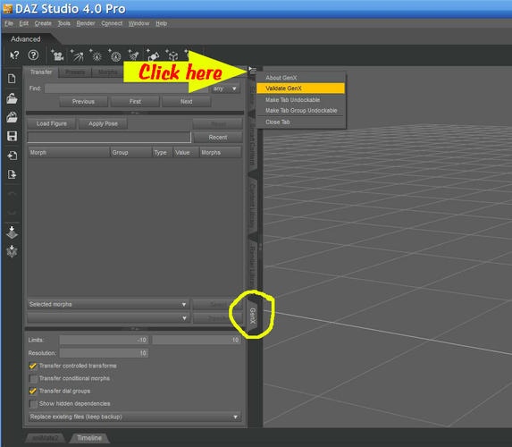

    Once you open the genx tab you validate under tab options. I will try to make a screen cap if you can't find it.

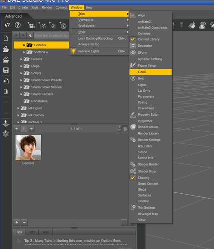

    Sorry, you mean you don't have genx under Window>Tabs ?
    Where do you usually install your plugins? Is Genx listed under installed plugins?
    This is where it should be:

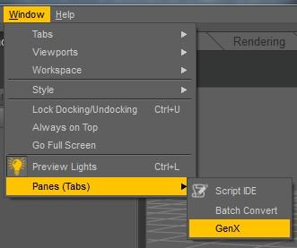

  • jestmartjestmart Posts: 4,449
    I don't have the GenX in the Windows/Tabs area either. It was in something new to me, Windows/Panes.

    Ahhh, I see where I went wrong. I looked in the Installed Plugins and it wasn't activated. That's why I didn't see it in Windows>Panes.
    Activated it, popped open the window. Unfortunately, everything is greyed out. I can't click on anything.
    Am I supposed to have V4/M4 in the scene or something? (Genesis loads by default for me).
    Edited to Add: Nevermind. I had to validate it with my Rendro order number and username. I figured out how to use it and did a morph transfer test. It works. :)

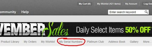

  • Knight22179Knight22179 Posts: 1,195
    Log in, go to "My Account" and across the top bar, look for "My Serial Numbers"

  • fixmypcmikefixmypcmike Posts: 19,713
    omen555 said:
    hmmm.... I purchased the gen x but can't seem to find the serial number to validate it lol! Where do I find the serial number?
    My Account > My Serial Numbers
  • omen555omen555 Posts: 0
    ...and there it is. LOL Thanks....for not laughing!

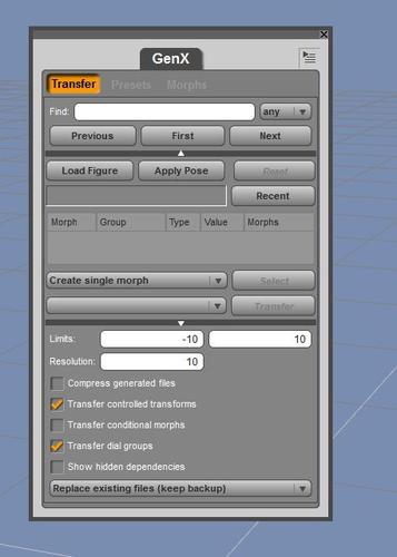

    Really I was simply interested in the Aiko 3 and Gen 4 figures. But the bundle was too good to pass up.
    After validation, Using the quick guide I opened up the windows/pane tab and Gen X was right there.
    I'm not sure if I should've seen the additional figures but I saw nothing of the add-ons.
    Further when I hit transfer and loaded Aiko 3 from my Poser runtime, Nothing showed up.
    When I loaded Aiko 3 from my DAZ Library, nothing showed up.
    Do I need to load a figure into the scene? The Quick guide didn't mention this as a step.
    Figure 1 shows the start.
    Figure 2 shows the loading of the figure Aiko 3
    Figure 3 Shows there is nothing there!
    Help!

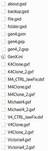

    I still can't GenX to work.
    Maybe this is my problem. I can see Gen X in the windows Tab but when I dig into the AppData\Roaming DAZ 3D\Studio4
    This is what I see.
    I'm lost as to what to do right now. My admin is my user account.

  • donewsdonews Posts: 51
    These are the files I found in C:\Users\my_admin directory and that I copied in the C:\Users\my_user directory.
    If you don't have a user account, may be there is an other account in C:\Users where to copy these files ?
