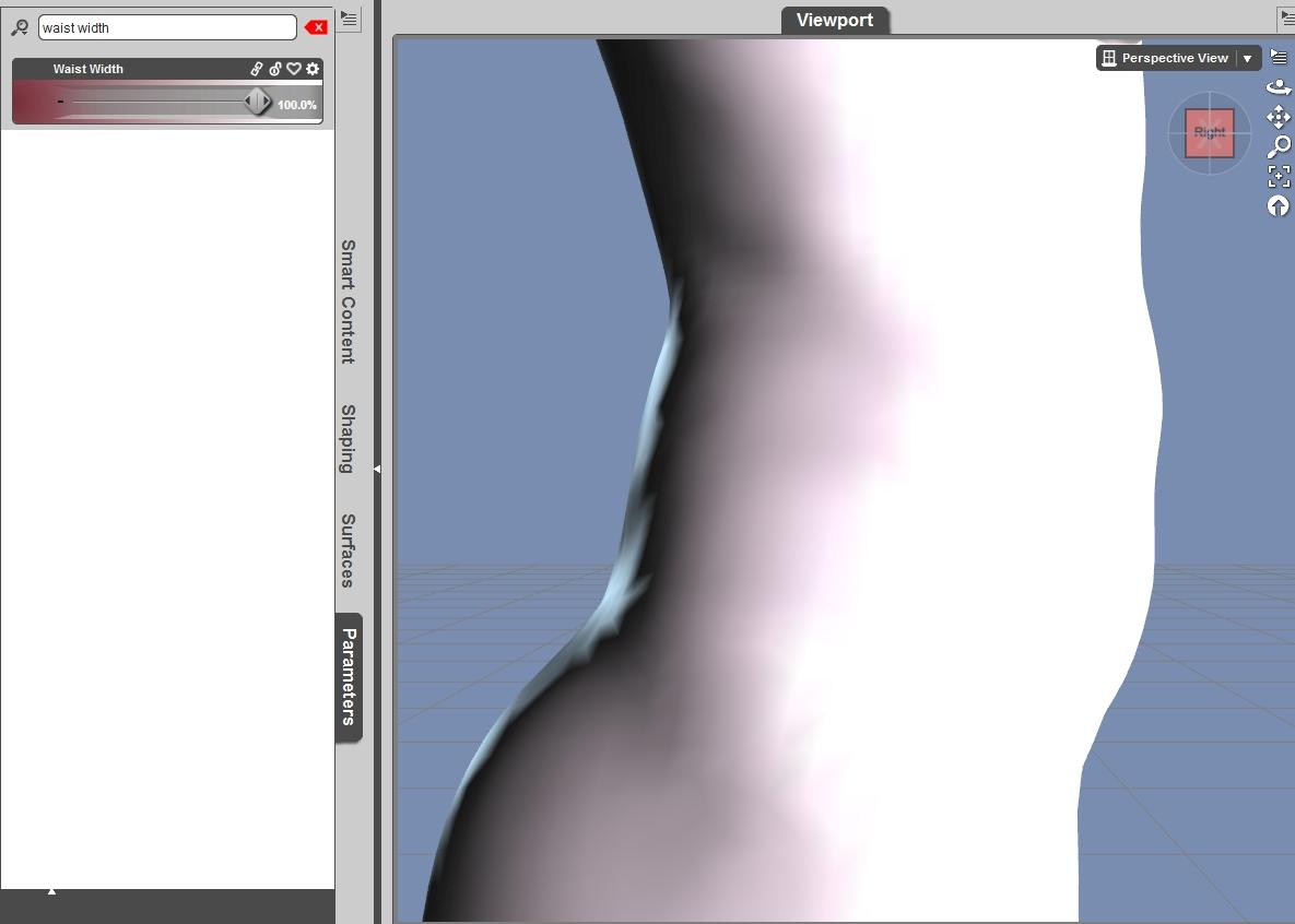

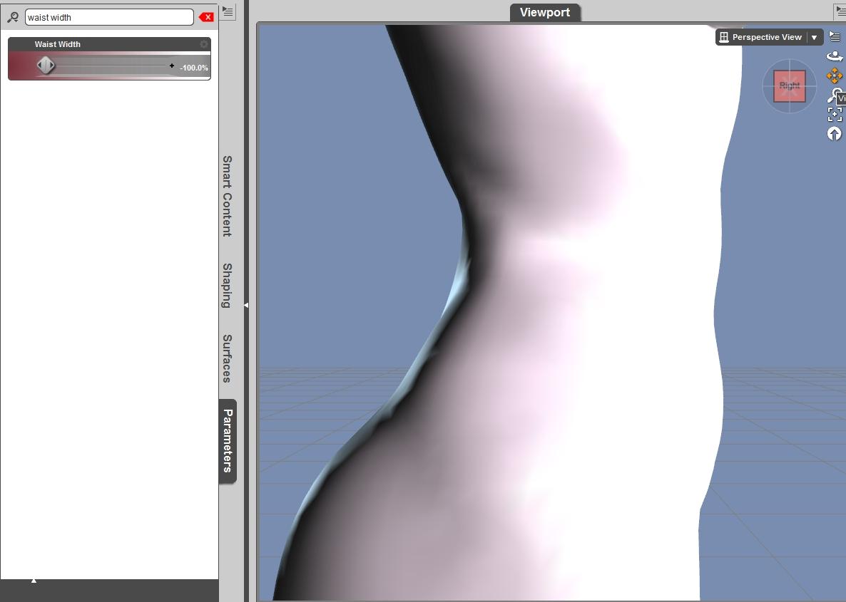

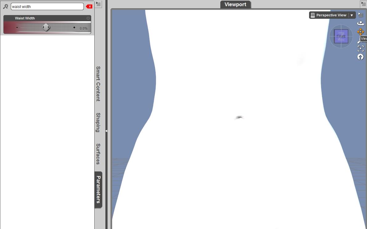

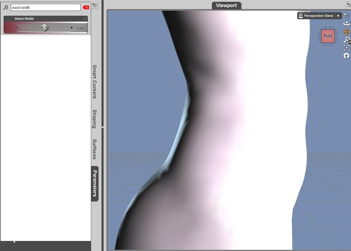

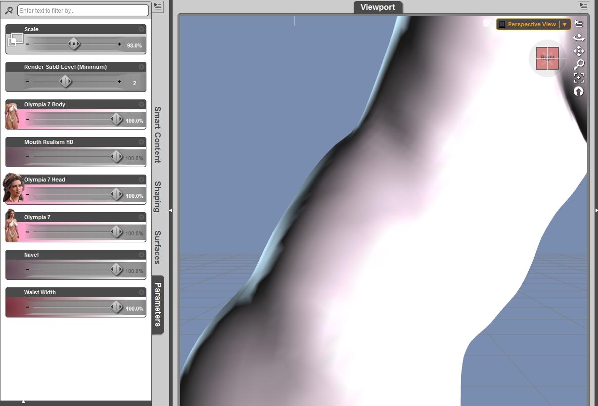

    I can't really show what Cosmo and Marble are seeing, since I'm not getting it as badly, I think. I hope the image titles and sliders will explain it well enough.
    If I've done this right: first picture is a clay capture of Olympia 7 shape with default waist width, front view
    Second image should be Olympia default, side view.
    Third picture should be waist width at 100 percent, side view. Front-to-back thickening is visible, as is a "pad" between her lower abdomen and buttocks.
    Fourth picture should be Olympia 7, waist width 100%, side view, lower abdomen bent forward.
    Hope this is helpful. I don't have Bend Control or Glute Control, so that's not an issue here. Also, I tried using the height morph to shrink both Olympia and Bethany down, but couldn't duplicate the issue that Marble described.
    EDIT: forgot one. Waist Width at negative 100%. Front-to-back narrowing is very apparent.
