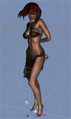

I finally updated to DS4.5 about 75% of the time when I save a scene now my genesis figure is distorted when I load the scene later.
I have looked for any possible morph settings, and I can't seem to find the culprit. This never happened in DS4x It seems most of the scenes saved prior to the update loads fine, but if I work on a scene and save it. Then load it a d day, hour, or even a minute later it looks like the genesis figure is all crazy along with cloths and hair.
If I Load a new pose position the clothes and hair jump back into place, but the genesis figure is still all distorted.

    Is this a .daz scene file that's been loaded and then saved as .duf scene file?
  • Richard HaseltineRichard Haseltine Posts: 111,873
    Try saving the messed up scene - a lot of people have found that that fixes the problem.
  • kitakoredazkitakoredaz Posts: 3,526
    save the "your.daz" scene (in which figure is exproded) as "new_your.duf" scene (set the name for duf scene file, what you want )
    it will make exproded shortcut img for duf scene files in smart content viewer,
    but ignore image, try load the scene ("new_your.duf")
    many files will be loaded with no exprosion (though a few files would tell you erroer message,
    if you have removed some assets of the scene,or changed path or name,, etc,,
    on that case you may need to serch the assets and load again. or just leave it off)
    then save the scene again as duf for your shortcut img to correct.

    God Bless you guys, saving the scene a second time brought at least one of them back, not time to check more must work to buy more Daz figures. Thank you so much. I hope they are able to fix this in a later version.
    And just FYI I have some that were originally saved under 4.0 and later saved under 4.5 and became a mess and I have some that I only did since 4.5 and saving them as scenes and the new duf file system caused this.
    So far I have not moved any files used in a scene, just a clitch of some sort.
    Here is what she looks like just saving the file again then loading the new saved scene it and tada'
