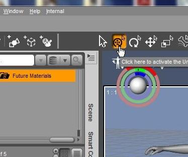

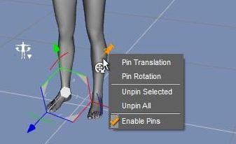

    OK, this will take a bit to explain, but here it goes.
    I'm using the City Limits Layout. Window > Workspace > Layout > City Limits > Accept
    With this new layout you will see many icons around the workspace. I select the Universal Tool Icon.
    Then when I pick or select the foot on the figure, the Universal Tool is displayed. Within that tool is a Pin Icon, this will give you some options to pin the foot in its location etc.
    This should help solve the issue.
    See the images below.

    Thanks All; I think pinning will solve my problem. It is a bit tedious but so was key by key adjustment.
