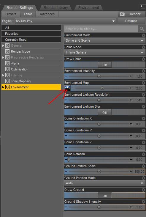

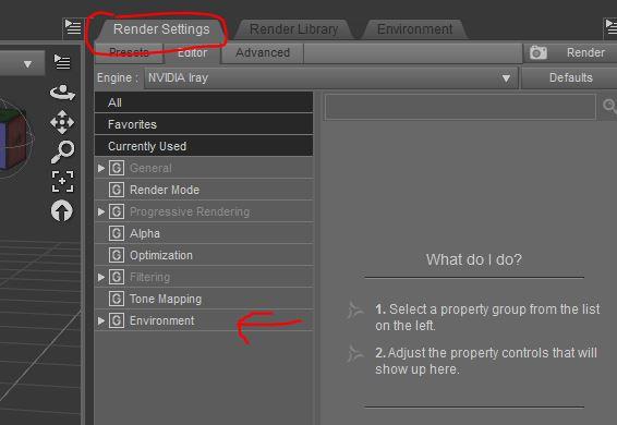

    They will work if they are plugged into the right slot. From what I gathered, you are inserting them into the Environment Tab, where the "Backdrop" option is? (I apologize if I misunderstood what you  are posting. It's late and my brain is kind of fried.)
    A HDRI image has to go into the Envirinment tab, but that tab is inside of the render settings:
    You have to right-click on the "Envronment Map", and insert your HDRI there.

    Draw Dome doesn't need to be on to create the *light* from the HDRi. The setting only displays the actual image.
    If Draw Dome is off, and you have verified it's not a reflection from the set itself (render an empty scene only), then a reboot is called for. Occasionally, Iray settings get funky -- such as lights no longer working -- and restarting your computer often fixes it.
    The HDRi itself will have no effect on, or control of, the Draw Dome setting. This setting alone controls whether the HDRi image is displayed or not.
