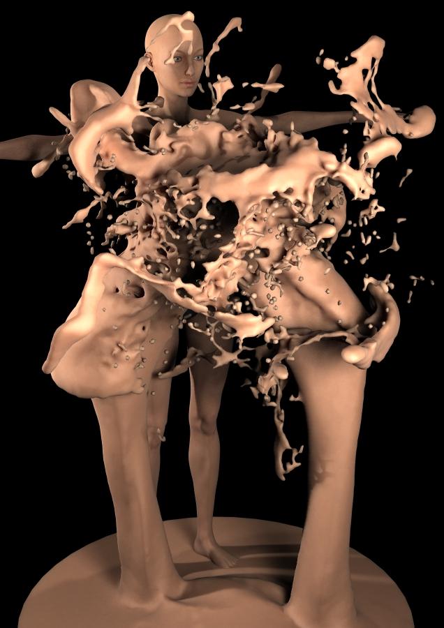

    Best I can come up with is to make a tiling texture with a suitable section from the skin tex and then fiddle with material settings to get a match.
    Don't know if it's going in the right direction for what you want?
    Edit: After having a little bit more of a play. you don't have to worry about tiling. It only seems to take colour info from one spot on whatever diffuse map you use.

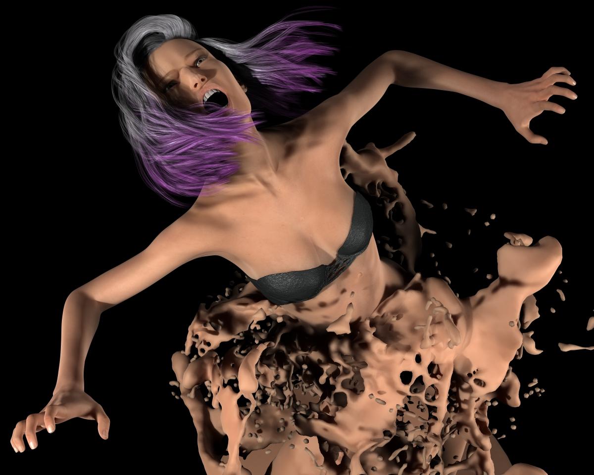

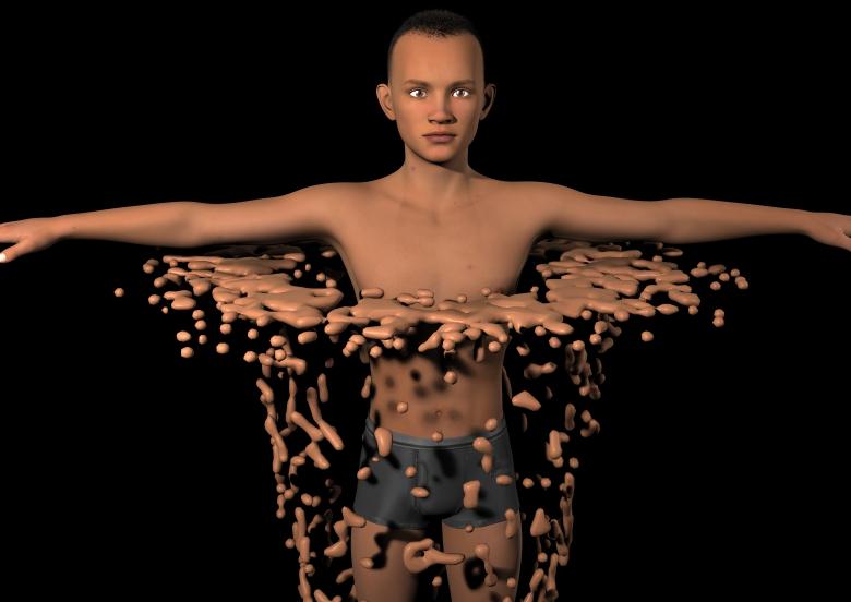

    Hi, these props use some kind of shader that  I don't know anything about (procedural maybe) but I have worked out how to get them to match a figure models skin tones. As well as the results below anyway. I'm not to good at writing clear instructions but will start working on them now and should have them up in a couple of hours.
    Are these the sort of result you're after?

    OK
    First set your characters surfaces up as you want them (and save just in case). Using lights close to what you plan for the scene helps.
    Save the skin settings (Face or Body/Torso should do) as a shader preset.
    Copy a section (64x64 to 512x512 pixels is adequate) of the characters texture (again, from the Face or Body/Torso seem the best) and save as jpg (to a "Project Folder" or leave it in characters texture folder).
    Load the splash prop.
    Apply your shader preset to the prop (you may have to drag and drop).
    Open the Surface Tab for the prop and change any maps to "None" except the Diffuse, change that to the small jpg you saved earlier.
    You need to fiddle with gloss levels (whichever apply to the shader base you used to set up the characters material settings)
    This should get you very close but you can fine tune by using the tile offset dials to change exactly what colour the shader is basing everything on.
    Also lighting has a dramatic effect on final results. If you get lines and bumps on the prop surface try turning Smooth off.
    The first sample above was in D|S 4.9 and iRay, the other two in 4.7 and 3DL using AoA Subsurface shader.
    The one below, which I forgot to attach is also 4.7/AoA
    Edit: The water props aren't UV mapped.
    780 x 552 - 147K
    Post edited by Pack58 on
