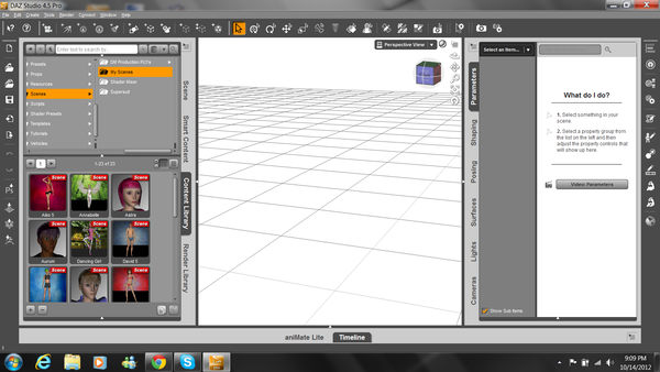

I'm not sure if this has been pointed out before, but I appear to be having program glitches with my finding all of my saved scenes in Smart Content and Content Library. As you can see in the attachment below, I am running the full 4.5 Pro version of DS and my File open is showing more scenes than the actual content manager. As you can see in my taskbar, I run a Windows 7, 64-bit.
In the past, this glitch was the result of me redirecting my scenes in sub-folders nested in my Runtime > Scenes folder. Accessing the scenes and resaving them would usually correct this. However, this isn't the case anymore...
Any ideas what this is and how I may correct it?

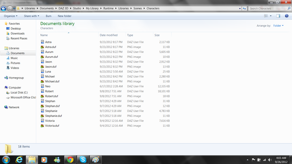

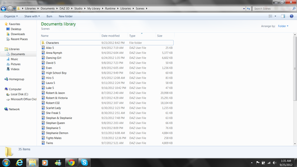

    Actually, most of the ones you see in the original screen are in a sub folder called "Characters". This folder can be seen in the second screen. However, as you'll also see, files like "David 5", "She-Freak 5", and "Stephanie 5" are actually saved in the Scenes folder outside of that.
    And as I said before in my original post, moving scenes into sub-folders would cause this glitch. However, simply reopening and resaving the files absent from the Smart Content/Content Library would correct this. Since files from both departments are present in my current Unassigned list, I don't see how the problem could be missing poser files...
  • fixmypcmikefixmypcmike Posts: 19,738
    Can you go into the Characters subfolder in Windows Explorer, sort by name, and post a screenshot?
    Is it possible that the files that aren't showing in Unassigned have been assigned? If you go to Content Library > Categories > Default > Unassigned, do you see the exact same set of files?

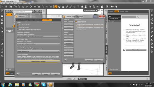

    Can you go to Edit > Preferences > Content Library > Content Directory Manager, expand the DS-formats and Poser formats, and post a screenshot?
  • RCDescheneRCDeschene Posts: 2,817
    edited September 2012
    Can do.
    1600 x 900 - 273K
    Post edited by RCDeschene on
    Puzzling, I don't know why DS should display them -- it shouldn't for any of them. Were the ones that are in the Characters subfolder done at a different time to the ones in the folder above it? If you try saving a scene to the Characters subfolder now, does it work? If you move one of the scenes that isn't showing up into Characters, does it work?
    Okay, it appears you're on to something regarding scenes created at a different time. It seems as though that only ones being effected by this are one's I created before the finalized release of DS4.5.

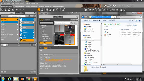

    In the screen grab below you'll notice that I saved a test Studio .duf scene to the Poser runtime Scene folder. It does not appear in the Content Library pane but is located in the Runtime\librarys\scene folder.
    If you Import Mapped Directories then it will show up in the Smart Content pane in the Unassigned category and you can see in the info section below that the path is to the runtime scene folder.
    I think what may have happened to you is that when you saved your scene files you didn't notice that you where in the Poser formats directory and at some point you had imported the mapped directories.
    Hope this helps... :)
    1366 x 768 - 249K

    Looking at your screen grabs, your scene files are in your Poser Formats runtime already. The Content Library will not show DS formats in the runtime unless there is a same-named poser file there as well.
    What I was showing is that it is possible for the Smart Content pane to show those DS files if you import the mapped directories, as I thought that is what your original question was. Sorry if I misunderstood what your question was...
    Unfortunately no, this will not recreate any missing thumbnails. You would need to re-save the scenes to do that.
    nicci... :)

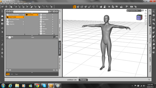

    Oh crap! I forgot the new screenshot!
    This is what I was referring to... (See Screenshot)
    As you can see, there's not even a tab for them, so how can they be in there? I know they're not saved anywhere else outside of what I've shown you all up until now.
    Should I try the risk of creating one?
    1600 x 900 - 274K
    You could, but I think you'd be better off creating it in My Library rather than under Runtime. Nested content folders are not a good idea.

    Ok, now I understand... As you can see in my previous post of the screen shot of my content library, there is a Scene folder showing in Poser Formats. I don't know why your's does not, other than maybe because our layouts are different.
    I agree with fixmypcmike, it's better just to move your Daz format scene files to the Daz Formats>My Library>Scenes folder.
    nicci... :)
    DS only shows the Poser libraries that are present in the runtime -- if you haven't installed any products that use the Scene folder, it won't show up.
  • niccipbniccipb Posts: 483
    Hi...
    That's very odd then, as that folder was always empty until I put that test scene there, but has been displayed ever since one of the DS 4.0 versions.
    Could a product that was Poser content that included an empty Scenes folder in the runtime have put it there? If so, then I understand...
    Well, I decided to take Mike's advice and created my own Scene folder in My Library. Everything is showing up as it should now! :-)
    1600 x 900 - 344K
