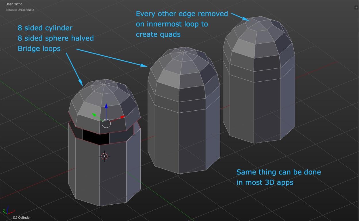

    Here is one way to explain how you can handle a cylinder with a spherical dome end.
    For making S or other curved shapes, does hexagon have the ability to work with bezier or nurb curves that can then be converted to mesh?  I work in Blender, but many 3D programs have similar things.

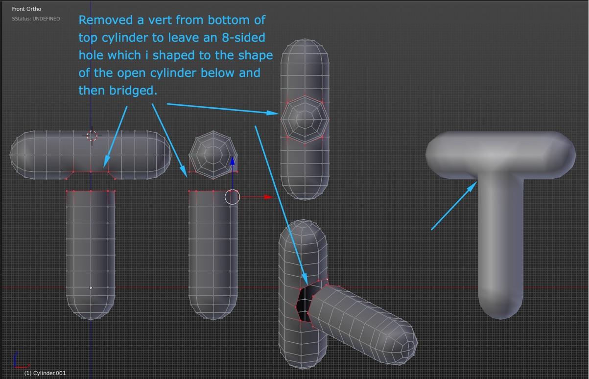

    Concerning joining two cylinders for a T, hope this is useful.
    1203 x 774 - 274K
    Post edited by Cris Palomino on
  • Roman_K2Roman_K2 Posts: 1,277
    Wow, that looks really good where you've smoothed the join at the "T" shape. Thanks!

    Every other edge removed on innermost loop to create quads...
    Ok re: the different way to round off a cylinder... I seem to be comfortable with multiple extrusions, in Hexagon and the "Close" function seems to work well -- it hiccupped the first time I tried it -- but I'm not up on my Buckminster Fuller-physics; not nearly knowledgeable enough at this end, to recognize a better way to close off a mesh.

  • Cris PalominoCris Palomino Posts: 13,041
    As to extruding and closing, you can extrude and on the final loop, merge to center.  You will then get what I have in my illustration and just remove every other edge to make the quads instead of the triangle fan.
    I used merge on the cap ends to merge the row of points into one.  Some programs call it welding.  Not sure for Hexagon.   Between sections, I connected with bridging.  I believe Hexagon has bridging.
