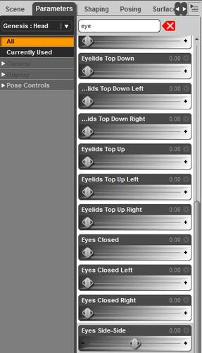

  • LindseyLindsey Posts: 2,013
    Expression morphs will appear if you select Genesis' Head.
    Try this:
    Select Genesis' Head
    On the Parameter or Shaping tab, select the All Group
    Search for eye
    If you don't have a long "eye" list like my example (I actually have 23 eye morphs), they came from the Genesis Head Morph pack.
    369 x 642 - 43K

  • jasonperijasonperi Posts: 20
    To make it blink, I would set a keyframe with the eyes open, then set another keyframe 2 or 3 frames later with the eyes closed, then another 2 or 3 frames later with the eyes open again. I hope that helps.
