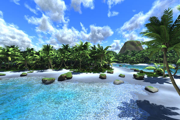

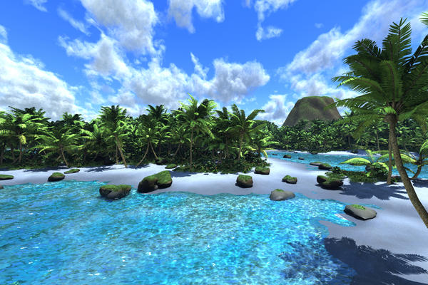

  • Rashad CarterRashad Carter Posts: 1,835
    I should probably explain a little further what I intend. In that long post I started using the terms indirect light and skylight a little too synonymously. In my own scenes I have developed what I call the EarthGlow Dome Light Strategy. It breaks up the elements of the outdoor light into three stages, Direct sunlight, diffuse skylight and diffuse ground level EarthGlow. The current proportions for a surface illumination are 2/3 indirect light split between the skylight dome and the Earthglow Dome with the Earthglow Dome a little brighter overall than the Skylight dome. The reason is as you observed, the sky itself can only do but so much but once skylight bounces off surfaces it in a sense gets brighter, amplified. Or another way to think of it, not all skylight is absorbed the first time it strikes the Earth so how do we account for the skylight that continues to bounce around from surface to surface? Clearly sunlight is intense and bouncing from surface to surface as well.
    Complicated multiple dome strategies are probably out of his league for now. But in time. For now he will probably have to try to do everything in one shot with the IBL.
    When we consider a scene like the one he is constructing with lots of sky, but also lots of obstruction by buildings and trees, he will need more light than expected.

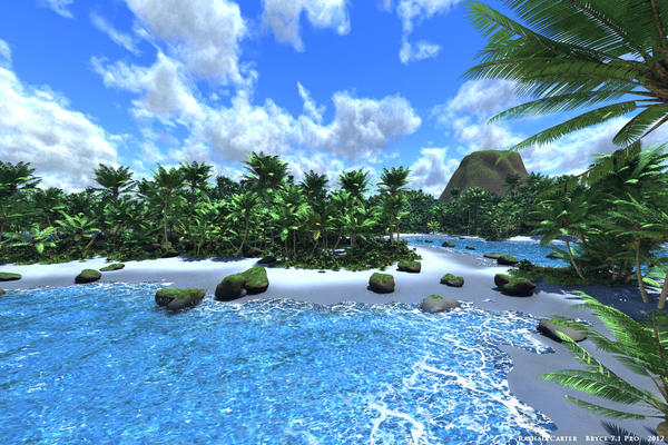

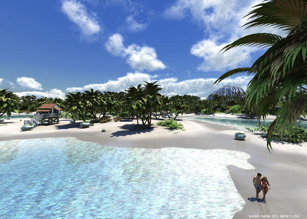

    Using one of my own works as an example, I have uploaded two versions of a scene I've been working on for a bit.
    The original version played it safe with all of the indirect light intensities right around the 1/6 range you described. Since the sky is dark blue, I assumed it would scatter only a small amount of light. The ground level light was also conservatively set. The light in this scene was intended to be that of a vivid mid-day tropical type of environment based on the basic rules. Over the next few weeks I noticed that sometimes when I re-viewed the image it no longer looked as my mind remembered it, it looked a bit like evening, like the sun was setting even though it was high in the sky, the shaded areas were just too dark. Why doesn't it look like vivid daytime every time I look at it? What missing? God knows the sunlight is plenty bright. What must I do next?
    I played around with the balance of total indirect light to total direct sunlight and discovered that to produce the vivid daylight I was after I'd need a lot more indirect light than I'd ever imagined, far beyond the 1/6 proportion because I needed to account for stray rays of light flying around all over the place.
    So here is a comparison. The original render used Bryce trees, the new one uses Carrara trees and I've even begun a new generation of trees because I dont like the way these turned out.
    Anyway, to my mind the second version does a much better job of creating that sense of vivid daylight than the original render.
    As always I am open to your feedback and respect your ideals so please provide any insights you can.
    I have also included a few example shots from the internet I'd like to use as references for the type of light distribution I was after.
    Clearly the type of camera used for these shots has a huge impact on the way they look, so in that you can also give me advice. Thanks Bud.

    Anyway, what I wanted to say was something about the water, why it looks wrong:
    Out of the five you posted, the first two are laughable when I consider your skills with Bryce. You're not an amateur but my dog can render better water than that. The last three, however, the water looks very good, but on the very last one, there is a perfectly clear indication of what's wrong with the water.
    Refraction looks wrong.
    Over recent months I've seen hundreds, no, thousands of beach and coastline photos of Ibiza (Spanish island), and one thing that strikes me odd about your last render is the refraction, it's picking-up far too much detail and that makes the water look odd. Number three and four don't appear to suffer from it as much, but the fifth makes it obvious that refraction is at least one of the issues.
    Comparing to render number five:
    Look at how detail is refracted in this angle:
    http://www.flickr.com/photos/victoriapeckham/6116273670/
    Compared to this angle:
    http://www.flickr.com/photos/globalestates/1589328828/
    You'll notice it hardly looks any different, so what you need to be asking yourself is, why?
    Lots of things to consider, but mainly, bear in mind the complexity of the ripples or waves because although that doesn't change the refractive index of the water in real life, when we render water we need to make-up for deficiencies we have elsewhere (and unless we're totally obsessed, we all render them). For example, we know if a face is fake because we pick-up on things, and it's the same with water, because although it is visually endless, we still know when something doesn't look right, and when a render of water doesn't look right, it is because we failed in other areas.
    The only way you will get accurate water is to know more about the water and model it, surface it, and render it as accurately as possible (remember, it's a ray-tracer, has no mind of it's own, and does exactly what you tell it to do. But we don't have to be super accurate, so we need to make up for that deficiency. So, while you might have a refractive index that works at a certain angle, it is just a fluke because other setting that are wrong are allowing it to pass as acceptable, but that might not be the case when you move the camera to a different angle.
    Shapes of the ripples themselves is going to be pretty much essential to make it believable, and this is why people find it easy to render calm water but fall flat on their faces when they attempt an ocean. Calm water can be anything from a glass like finish (easy) to a slight soft-edged ripple (still easy). Oceans are a totally different thing, and if you give your water the properties used for an ocean when you're rendering calm water, we know it's not right the moment we see it.
    Not very technical I know, but it's the same no matter what we render (I've pointed this out many times). Whenever can't do that, forget about following simple things like, ah, I set my refraction to water so that must be correct. Nope, so as well as the refraction you need to consider the shapes of the ripples and waves as well.
    Another aspect of making such a render believable is demonstrated here:

  • Peter FulfordPeter Fulford Posts: 1,325
    edited September 2012
    Well I was having a cup of tea at work - but now I'll have to wipe it off the screen and go and make another.
    Yeah, c'mon Rashad - you can do better than that! :mrgreen:
    Post edited by Peter Fulford on
  • pumecopumeco Posts: 0
    I don't know what's funnier:
    A - You being a posh git and still having to make your own tea, or ...
    B - You haven't noticed the refraction is indeed wrong :mrgreen:
    And anyway, I was being perfectly serious.
    Refraction (and Reflection (and Specular)) are vital, especially with stuff like water which depends on all three. People screw-up on water a lot, just like they screw-up on eyes a lot. I mean how many times do you see a render where the eyes look dead or glazed-over?
    I see it a lot, too often, and It's the same sort of problem that arises when dealing with water. To deal with it, things need isolating and to be tweaked in a more controlled scene environment if accuracy is needed, otherwise, it's just observational, knowing when it looks wrong and tweaking it in it's surroundings at a predetermined camera angle until it doesn't.
    PS: The only reason you have to wipe the Earl Grey off' your monitor is because you saw that arse. At first, there was merely the sound of the bottom of your cup rattling against the saucer as you trembled, but then suddenly you could contain yourself no more and, well, found yourself needing a cloth for the monitor :-D
