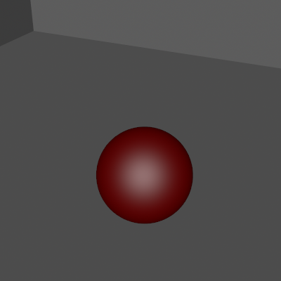

  • ToborTobor Posts: 2,300
    edited April 2016
    Here are some visual helpers (hope they show; image attaching is being a bit touchy right now). Comparison between headlamp (defaults), distant light (slightly rotated to demonstrate shadowing), and point light (offset similar to headlamp, emitter changed to 4cm disc).
    The background is a simple curved plane. Ground shadows is on in all three; for me, I only get the ground shadow with distant lights, not with headlamp or point. Maybe that's just me...
    Rob has pointed out that D|S uses the DzDistantLight object as the basis of the headlamp, but I think this demonstrates that whatever properties have been modified from this object, the result you get from a headlamp is the least like a distant light. At least, for Iray, which after all is the default renderer now.
    1200 x 1200 - 103K
    1200 x 1200 - 137K
    1200 x 1200 - 100K
    Post edited by Tobor on
    edited April 2016
    For Iray, yes, there are shadows for the headlamp.  For 3DL, no there are not...
    3DL
    Iray
    400 x 400 - 95K
    400 x 400 - 85K
    Post edited by mjc1016 on
