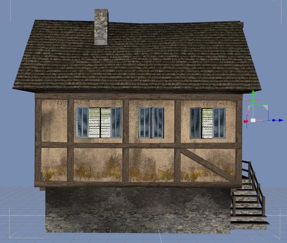

I don't know if it give some info but this how a model with TGA texture appear in editor
And how it appear with PNG created from the TGA (Only texture, I have to convert other files (Spectacular,opacity ... ))
For the both render are OK.
