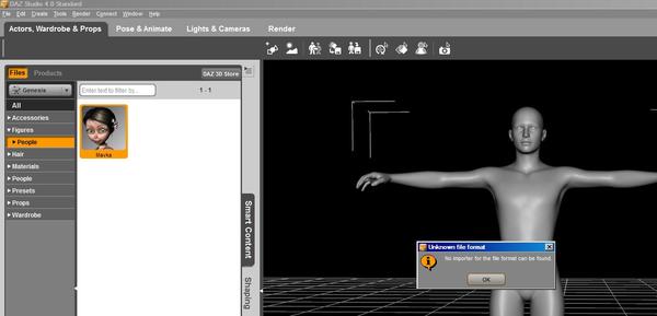

Could someone tell me what I need to do next? Would love a simple no trills explanation or a visual tuts would be nice.........

    You are trying to load a .DUF file, and you do not have the latest version of DS4. You need the latest version of DS4 for that.
    On the Product page it says
    Compatible 3D Software : DAZ Studio 4.5
    You are also running DS4 Standard. You need to enter your DS4 Pro serial number from your account, close DS4, and reopen it again.

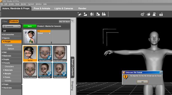

    OK done the adding the serial number and as you can see it worked, but what do I need to do now?
    1156 x 641 - 87K
    You need to look in Help > About DAZ Studio, and that will tell you what version you are running. If it is 4.0.x.x, then you will need to download the latest version. If you reset your download from your Itemized Order Hiistory, you should get 4.5.0.114 which will work for you. It has a seperate installer for the content called Gensisi Starter Essentials which must be installed as well. It updates Genesis to the latest .DUF file format, and loads the rest of the content as well.
    There is a newer version available in the store, 4.5.0.137, which fixes some issues that 4.5.0.114, but it is still classed as a Beta (Iuse it with no problems so far though) It is really up to you which one you install, either will load Mavka for you.
    The Beta version fixes a problem with Uberarea lights, so if you use them, then you should really get it. Hope that all makes sense?

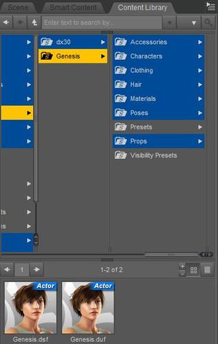

    I do not get Orphaned Files. I have both listed as good files. I have the .dsa and the .duf files listed side by side. What should I do? If anything, I mean it all works, I load the .duf files (they load faster for me) but is my Database FUBAR? I do get some of those Duplicate errors from time to time but everything works. I've backed up my database as it is should I do anything?

    The old versions should have gotten uninstalled when you installed DS4.5. Having the extra files shouldn't cause a problem AFAIK, as the Data folder files should still be .dsf, so the old ones would have gotten overwritten, but I don't know that for sure.

    This is my Default Genesis folder. I did let 4.5 Uninstall at install, I have doubles (no ! icons) for all default Starter content. Nothing else has that issue. Just the .duf files, all of them.

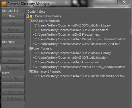

    And my paths are fine. The LOH one is MY props (items I make and texture myself) that I test in that folder.
