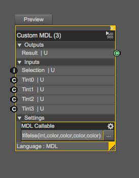

  • EsemwyEsemwy Posts: 578
    This is the best I could come up with.
    mdl 1.1;using df import *;using state import *;using base import *;using tex import *;using math import *;export color ifelse (    uniform int selection = 0,    uniform color tint0 = color(0.),    uniform color tint1 = color(0.),    uniform color tint2 = color(0.),    uniform color tint3 = color(0.)) {    color tint = color(0.,0.,0.);        switch (selection) {     case 0:        tint = tint0;        break;    case 1:        tint = tint1;        break;    case 2:        tint = tint2;        break;    case 3:        tint = tint3;        break;    default:        tint = color(0.,0.,0.);        break;    }        return tint;}
  • Oso3DOso3D Posts: 15,116
    Ok, something is definitely wrong, then, because I copy/paste that into the custom MDL callable, and ... it doesn't accept it and reverts back to 'state::position()'
    It loads for me as a standalone brick. Is the directory where you place the file setup as an MDL directory?
    Oh, and I just dragged and dropped from Finder (Explorer on Windows) into the Shader Mixer pane.
    What I'm doing: dragging/double-clicking/alt-dragging 'MDL > Custom MDL' from the Brickyard into Shader Mixer.
    I then click the '...' for the MDL Callable and paste in the code snippets people have suggested. I hit accept.
    It then shows... the same default as when I had initially dragged/double-clicked/alt-dragged.

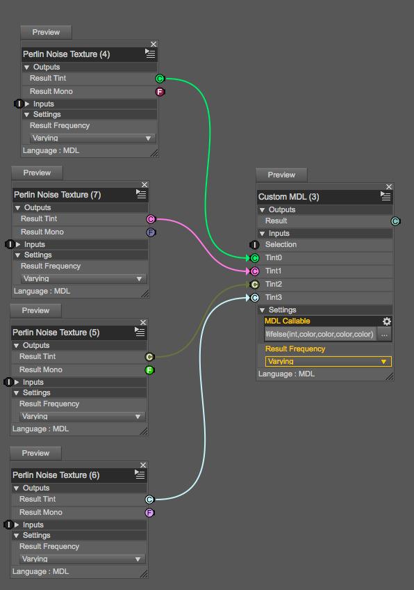

    Open a text editor, copy the code Esemwy posted and save it as <something>.mdl into a folder mapped as an mdl directory.  Then drag and drop into Shader Mixer...
    THAT did it! THANK YOU!
    ... But the color output of perlin noise can't plug into the color input of the switch.
    My wife often wonders why I don't go into coding because I seem to have an 'aptitude' for it. Yeah. This is why. So screamingly frustrating.
  • hphoenixhphoenix Posts: 1,335
    edited May 2016
    I think that's because the MDL listing above is using a 'uniform' tag, instead of a 'varying' tag.  Perlin (and other noise) functions vary across the surface, so they can't be considered 'uniform'.
    Try it by altering the inputs to the shader definition to be 'varying' instead of 'uniform'.
    Post edited by hphoenix on
    Derp. I actually tried turning most of them to varying, but I either didn't refresh or ... something.
    Thanks for helping this noob. ;)
    edited May 2016
    Found it! The parameters do need to be varying rather than uniform. And you have to exit DS before it will discover the new parameter settings.
    mdl 1.1;using df import *;using state import *;using base import *;using tex import *;using math import *;export color ifelse (    varying int selection = 0,    varying color tint0 = color(0.),    varying color tint1 = color(0.),    varying color tint2 = color(0.),    varying color tint3 = color(0.)) {    color tint = color(0.,0.,0.);        switch (selection) {     case 0:        tint = tint0;        break;    case 1:        tint = tint1;        break;    case 2:        tint = tint2;        break;    case 3:        tint = tint3;        break;    default:        tint = color(0.,0.,0.);        break;    }        return tint;}
    Post edited by Esemwy on
    It's the exiting DS part that I was tripping on.
