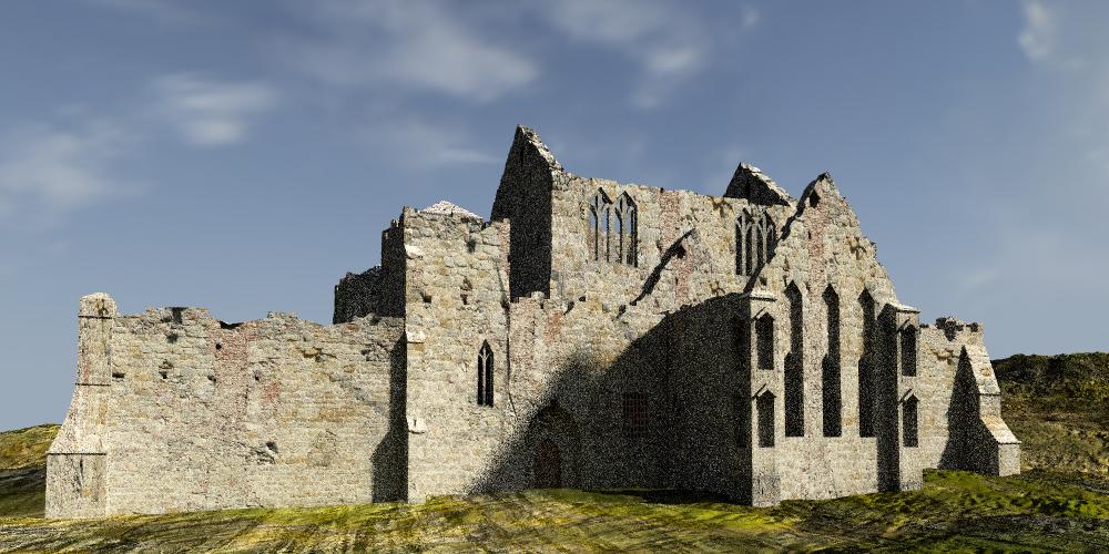

    edited April 2016
    The model does work OK in Bryce. The problem is that the mapping for the texture is 'Object Cubic' and the model hasn't been particularly well put together from a technical pooint of view. It consists of many components  (I believe made in Wings3D, reading the comments on the download link from other people who have experienced problems). It looks to me like it had been entirely materialed up in Bryce using four or five different stone type picture materials, none of which have a bump channel and some of which have a horrible amount of Ambient set.
    None of the material zones are grouped so fixing it up would be a long(ish) task not made much easier by the fact that Bryce's export feature doesn't usually do a good job of baking the materials on to models.
    This is what it looks like in Bryce (very quick render), I'm just exporting it now and will then try and import it into Poser (I don't use Daz Studio) and report back.
