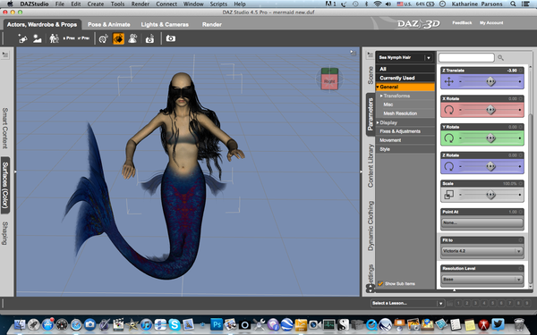

    I am also trying to contact the vendor Valea, who made the Sea Nymph hair. I have autofitted to V4 and this is what I get (see screen shot). I can manually move the hair down to her head (I have tried parenting to the hea, so that helps, and it stays on her head when I move her, but when I exported her as a Collada the hair winds up on the ceiling!).
    So any help for this poor newbie in attaching the hair properly or contacting the vendor Valea?
    1440 x 900 - 568K
  • JaderailJaderail Posts: 0
    First, Do not Auto fit the hair. Just load it Position it and then Right Click and Parent it to the Head.
    Second, Always Load and Parent the hair when the figure is still in the Default T pose.
    Third, Only Genesis hairs load and work 100% in 4.5 and 4 when auto loaded. I never AutoFit the Older hairs when Using 4.5. They just work better that way.
    For me anyway. Others may know trick's I do not.
    In that product there are two different hair files, one for Genesis, and the other for V4, so there is no need to use Autofit. How were you using it anyway, Autofit is designed to fit Gen 4 items TO Genesis?
