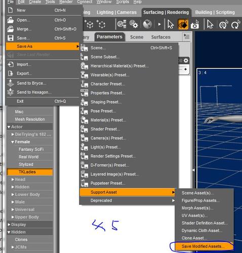

    and save the morph again , or use "save modified assets" in property group editor(4.0)
    or from top menu.(edit CAUTION
    you can overwrite defaut value only by save modified assets,
    can not overwrite "value"(current value) by save modified assets,
    so you need to save the morph again.

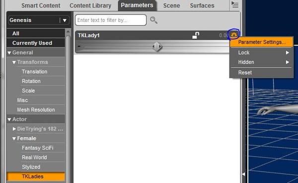

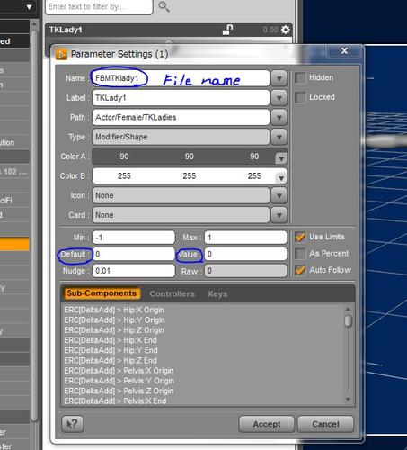

    @Skelch,
    you can check the morph real name from the morph controller small gear , and if it name FBMV5_1 (I do not know,,)
    ... \Mylibrary(Your default contents folda for ds)\data\DAZ 3D\Genesis\Base\morphs\vendor name\product name\FBMV5-1.dsf

    I am sorry there is mistake about save modified assets.
    if the morph current value has changed, and the morph was saved,
    must need to reset the morph current value to zero, and save again the morph
    to overwrite the morph current value.
    if defautl value has changed, you can overwrite the morph by "save modifeid assets"
    but "current value" can not save by save modifed assets,must need to save again as morph.
    you may need "product name" and "vendor name" for overwrite morph certainly.
    If you can not be clear how to overwrite the morph in ds 4.5 (about folda names,pr producct names)
    , you need to edit the morph fyle code by text editor, and save it again.
