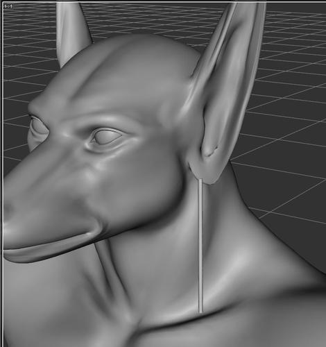

    A GeoGraft has to join to the host figure - if it doesn't there's no point in GeoGrafting. So you need an area that encloses the area you wish to change, and you duplicate the edge loop enclosing it and build your mesh in from that. When set-up and applied the GeoGraft hides the area of the original figure enclosed by the boundary, replacing it with its own mesh. I don't think this is what you want.
    A rigidity map specifies that certain polygons should deform as a unit, keyed to a single polygon that is a logical anchor point for the item. It will scale and translate as DS auto-generates morphs, but only as the anchor polygon does - without a rigidity map each piece will deform to maintain its relationship with the nearest part of the figure it is fitted to. This affects only the auto-generation of morphs, it doesn't affect distortion from posing (which would be handled with weight-map adjustment), nor of course does it affect custom morphs created in a modeller. The attached images show a simple cylinder turned into a conforming figure - the first is what happened when I dialled up the morph on Genesis without any rigidity map, and as you can see the cylinder has distorted as it tracks the changes in the head shape; the second image shows what happens with a different morph after I created a rigidity map including all polygons and set the refrence point to be one of the top polygons, touching the lobe of the ear
    842 x 895 - 68K
    562 x 664 - 32K
