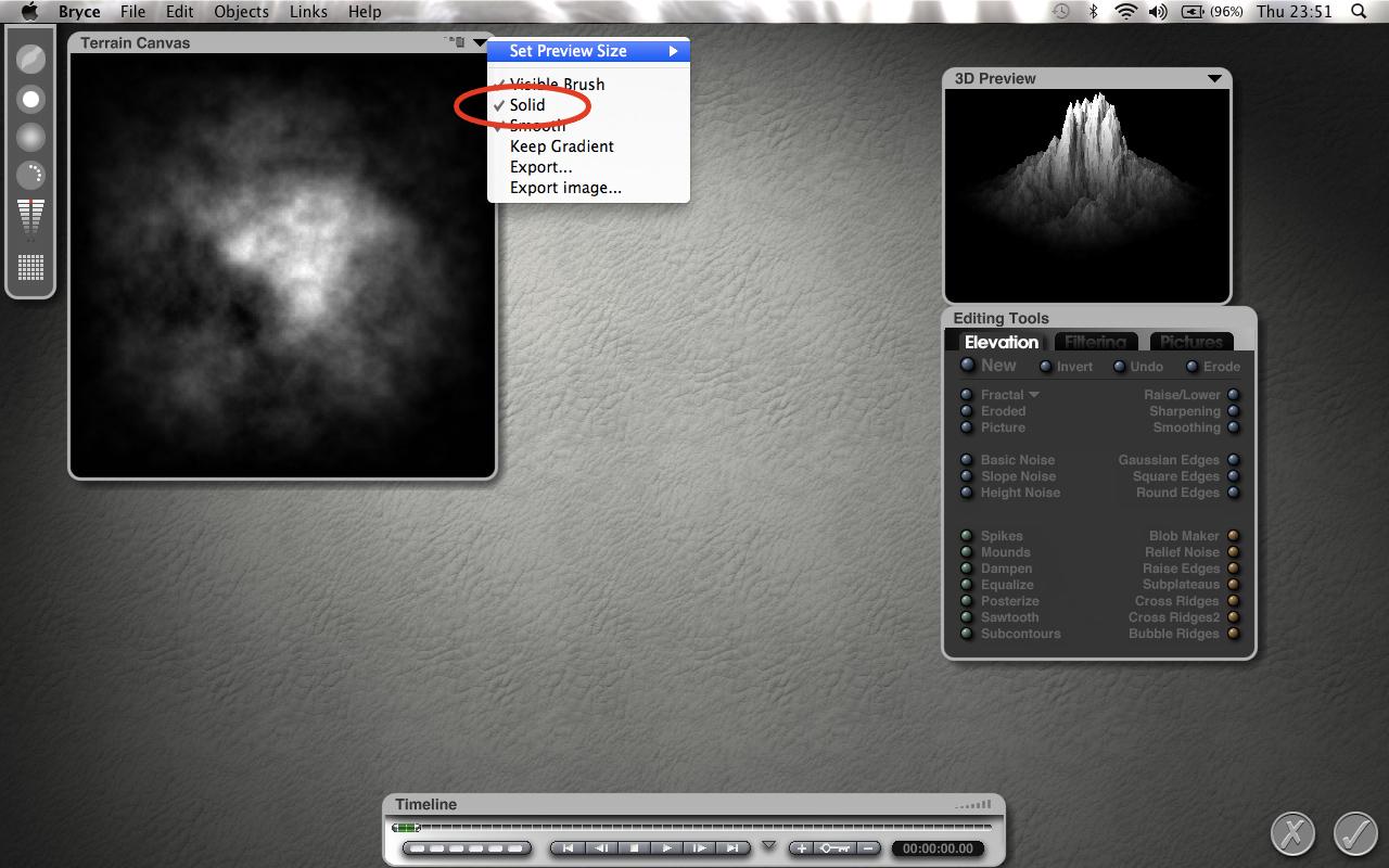

You need to go into the Terrain Editor (select the terrain object and click the little E button).
Down the side of the main painting window there is little triangle pointy thingy (real technical term that is).
Click on that a drop down menu appears, make sure you've got solid ticked (marked below in red).
Then click the tick button bottom right to exit the terrain editor and it'll work fine.
Hope this helps
