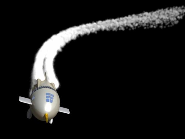

    That's it! :lol: Great catch Fenric!
    Carrara is caching the first render result, made either in the Render room or spot rendered in the Assemble room. Since I was only rendering a single frame, I might never have caught this.
    As you said, rendering a short animation seems to reset the particle size correctly. Closing and reopening the file also works, but what a pain! Perhaps there's a easier way to force a reset.
    Thanks for solving the mystery!
