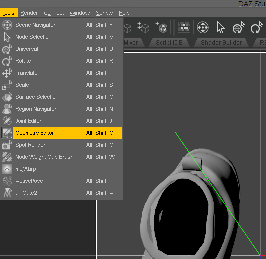

    To start with, you need to get the Geometry Editor tool open...

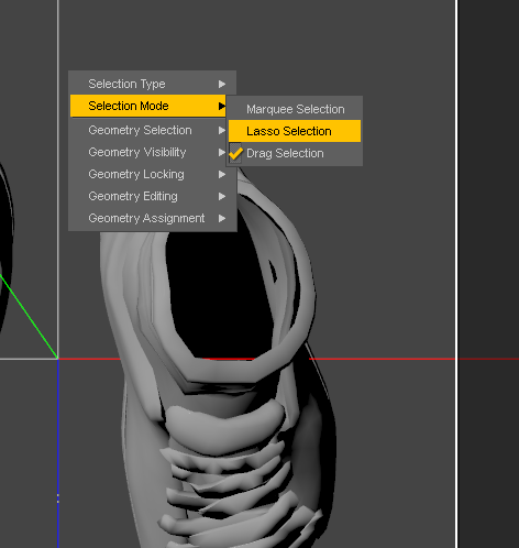

    Then change to the selection tool of choice...I like the lasso for this operation.

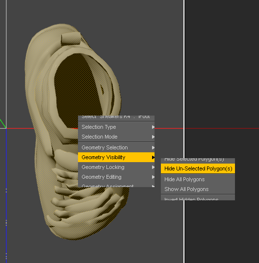

    Then hide the selection...

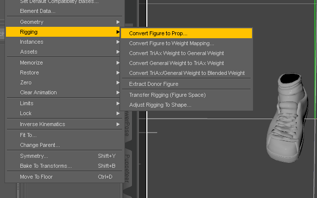

    edited April 2016

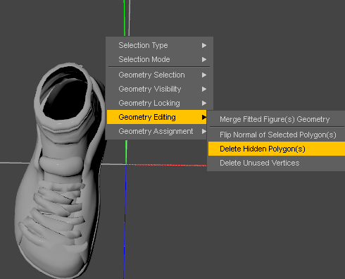

    Once the one shoe is hidden, you have a choice..generally I decide to delete the hidden polygons...this has the advantage of making the center point in the remaining item.
    Then depending on the original you may need to convert to a prop (I usually do this anyway...)

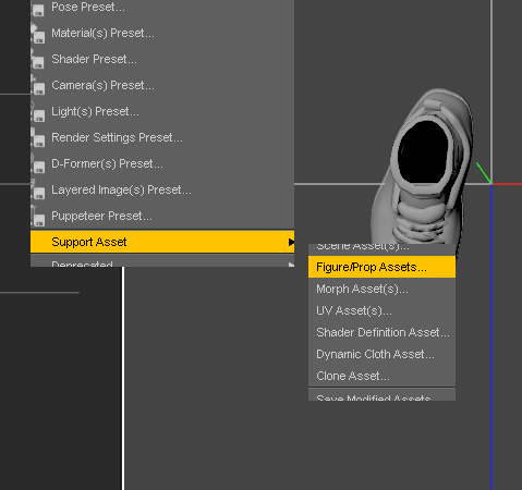

    And then save it...
    Repeat for the other shoe.

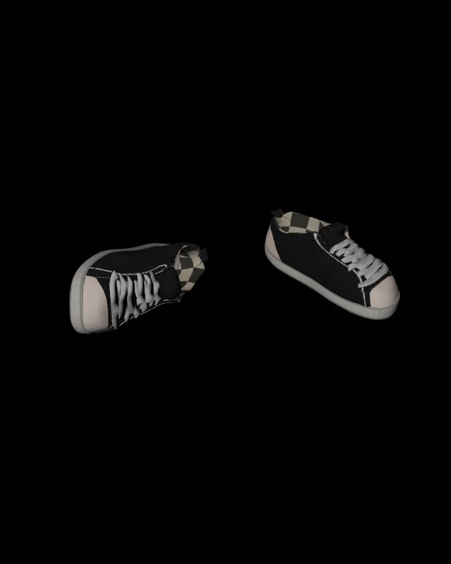

    And here is a quick render of the pair as 'props'...
