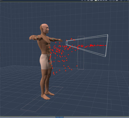

i've got a problem using emitters which is driving me slightly nuts
it's been a while since i've used carrara in anger, but i've come back to it recently, and i know i've had this effect working ok before, but now... it won't
i know how emitters work, and i can get those working ok to generate various particle effects. what i want is for the particles to collide with scene objects
if i add, say, a plane into the scene, and add it as "Collide with Scene Objects... Only.... Plane" that works fine, as expected. the particles hit the plane and don't go through it (as in the 2nd attachment)
BUT, if i try the same thing using a character (i've tried v4, m4, and v3 all to no avail) and do "Collide with Scene Objects... Only... M4 (or whatever)" then... the particles pass straight through the figure (as in the 1st attachment)
i'm sure the answer must be something obvious, but at the moment i'm stumped. any suggestions would be welcome
300 x 225 - 25K
300 x 225 - 27K

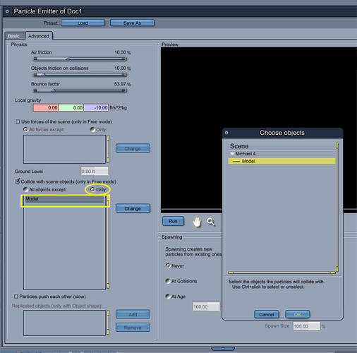

    the particle collision is set within the advanced options in the particle emitter editor, (see pic)
    You need to enable the particle emitter, to create particles which can collide with scene objects.
    The default set-up, where particles will collide with the floor, is really set-up to stop the particles at 0 height, whether there's is a floor plane in the scene or not.
    The real physical object collision is enabled in the particle editor, with the option to specify which objects to collide with,.. (or all objects)
    419 x 639 - 58K

    thanks for the reply, and i don't wish to sound ungrateful for the assistance, but i knew that already
    as i said in my original post, i'm able to quite happily get particles to collide with a simple object such as a plane (or a sphere, or whatever)
    what i can't seem to do is to get them to collide with is one of the human figures such as v4, or m4 or whatever. they pass right through them - as shown in the first image in my original post (the second image demonstrates them being blocked by the plane object)

    Further investigation shows that it actually works,.. and possibly as it should,. or,...works the way Carrara handles groups.
    The Michael 4 (listing) is the main "group" for the actual 3D geometry and rigging,..
    The Model (listing) is the actual "object" which could be collided with.
    So, If you select the option to collide with "Only" selected objects,. then branch open the Michael4, and select "Model", then the particle will collide with it.
    The same applies to V4.
    Hope it helps :)
    768 x 759 - 93K

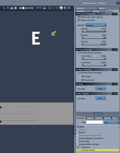

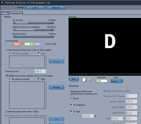

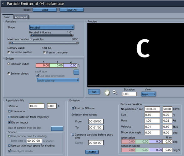

    Requesting particle collision help. Does not seem to be working for me. How can I keep my particle emitter particles from passing through my model, and have them rest on top of my model? See images for current settings.
    A - Emitter start
    B - Emitter end
    C - Emitter Basic settings
    D - Emitter Advanced settings
    E - Physical Properties settings
    Thanks in advance.

  • DUDUDUDU Posts: 1,945
    I can see that "Die in impact" is checked...
    Look also at the materials of the blobs and of the object which collide with, and uncheck the gravity of the scene and set the collision distance at 0 or 1.
    You may also need to increase the metaball influence. try setting it at around 2 to start.
    You may also want to look at the effects tab of the object that you are trying to have the emitter place the particles on, and set the surface properties to have low bounce and high friction, just as you have in the emitter.
