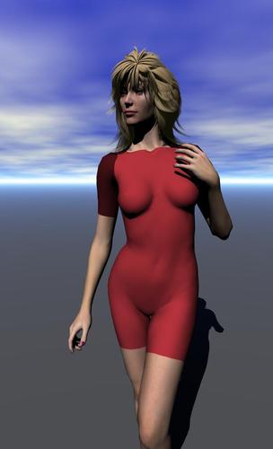

I loaded the V3 shape for Genesis, the Lana Sample wetsuit texture, and used the bridge to get it into Bryce with no problems, although the hair needs fixed.
Ia m using DS 4.5.0.137 and Bryce 7 Pro 7.1.0.109.

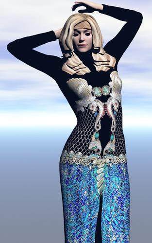

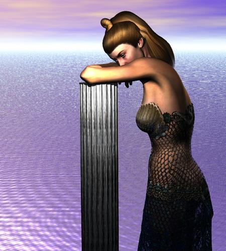

ere is one of my successful Export from DAZ4.0 to Bryce 7Pro. The hair looks solid because it doesnt seem to have transparencies to apply. It is "MirandaJones" hair by ktaylor/Mylochka from ShareGC for V3/V4. I like it for the sleek pageboy look The top knot can be hidden or covered with a rose. I wanted to see how plastic or how ok it would appear. The image was cropped and I applied a "multiply" layer to see details otherwise too washed out.
The dress is V3 Princess of Atlantis from DAZ overlain on the V3 MFD on top of the V3 clone on Genesis. This is a net style dress with embellishments and embroideries. The transparencies do not export from DAZ4.0 but it's a quick fix in Bryce. I just go in and copy/paste the mask for several items. Bryce is smart enough to load the correction into the rest of the garment. This is one of my favorite outfits for a mermaid theme. I also have the V3 Princess of India outfit, and it worked the same way with Export. Extreme poses do not work well as I don't understand "handles" and the DAZ4 pose controls are not so clear to me as far as how they are listed and what they will or will not do. I liked the old diagram with the dots in DAZ3. Could twist a leg right round the whole body with a crazy sweep of the mouse!
Send to Bryce just crashes in DAZ 4.0. I hesitate to load 4.5 because of the same discussions mentioned. I'll wait a litte bit more, because I do want "backwards" ability with the files. I still have Bryce 5.5 scenes that I like that I might want to adjust pose in DAZ3.
I thought this was a good test for V3 on Genesis.

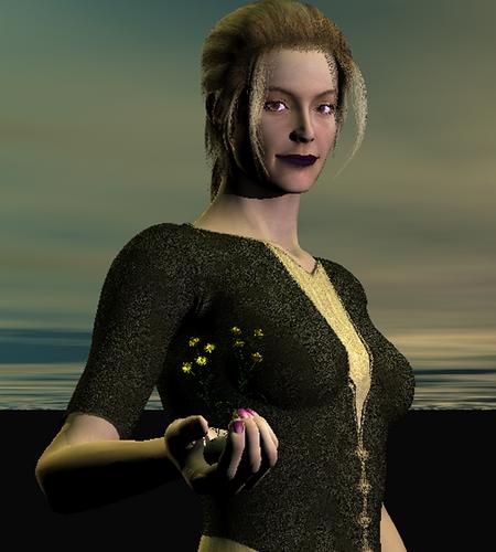

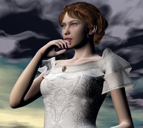

Here I worked in DAZ4.0 with the V4 clone overlay. with the V4/M4 Shapes. I used DAZ Tootsie/Classic Roll hair for V4 and a Crinoline short sleeve dress by Jan19 with texture by Chohole from ShareGC. The body texture is V4 Elinoir by StudioArtvartanian. The clone injection for Elinoir. did not work. I like to use textures where there is not a lot of makeup and there are more distinctive eyebrows and thinner lips.
The dress is problematic as it is not very flexible, and the necklines are loose. A better strategic pose helps with all the crinolines. I love the textures that Chohole made for Jan19's crinolines, which are available on her website and also at ShareGC. They come out so well in Bryce with depth and transparencies for richness.
This image was rendered too dark. I did not place another light which I normally wood. I used a "screen"layer and cropped.

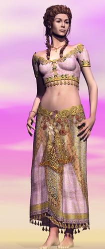

This is the Princess of India on MFD for V3 from DAZ loaded onto Genesis in DAZ4.0 with the V3 Shapes. Necklace is on the V3 Fantasy collar. The body texture is V4 Sundari by vyktohria but you can see the facial structure is still V3. Kinda neat! The hair is Wild Orchid DAZ/PropsChick and Goldtassel. I didn't add the flowers only adjusted the pose of the front braids to rest properly on chest.
I really liked the V3 clone accepting the V4 texture --that was kind of magical. Not every texture seems to strectch on the V3 if there are too much morph-specific makeups.
The image was cropped, and I used a "screen" layer to show the details better since I had rendered in Bryce this one darkly.

It's occurred to me, duh! That I should show a before and after so the Exported model from DAZ4.0 can be understood better.
Here is the Princess of Atlantis on V3 MFD loaded onto Genesis via the V3/M3 shaper plugin. Using the Export function in DAZ 4.0, choosing to use names of surfaces, and the rest of Rashad's suggestions. The hair is Sissy leBeaux by StudioArtvartarian. It is a particularly flowing and "fluffy" hair so I chose that as a good example for this export.
This model will not "send to Bryce" from DAZ 4.0.DAZ crashes and Bryce twiddles its thumbs waiting requiring a forced shutdown through TaskManager on Windows7.You know it's going to happen just before it does, when Bryce pops up a window that says "Please Wait". about a few seconds after trying to load. But it appears to be DAZ that crashes per Task Manager.
Anyway, back to successful importing! The first image here is the model as exported as on OBJ and imported into Bryce7 and rendered with AA regular. Observe the "black turtleneck", which is the MFD dress without transparencies loaded. The masks load, but Bryce doesn't copy/paste to obtain them, one must do that for each set requiring the masks, in Bryce's texture window. Sometimes, the Blend Transparency is not checked, or the button is not placed in the transparency tray. I just exported this from DAZ4 today and imported/rendered in Bryce to show what I am talking about. Next is an image of the same model that I had reworked in Bryce to get the transparencies on the dress and the hair.
Ice Scribe: I personally don't think the Vickie in the white dress is rendered to darkly. With the dark portion of the sky, the way the light hits the figure, the shadows on the figure, I personally think you've done a real good job. To me, the mood says "I see something that's a bit frightening." I also like how the figure standing on the water turned out. Another nice image.
@GussNemo
thank you for the encouraging words. I found by using the large tilting button, the skies can be very different than just a straight on loading. Like the figure in white's skies, they can take on interesting shapes that can add to the mood. I did light that one with a distant round light, but moved the light away.

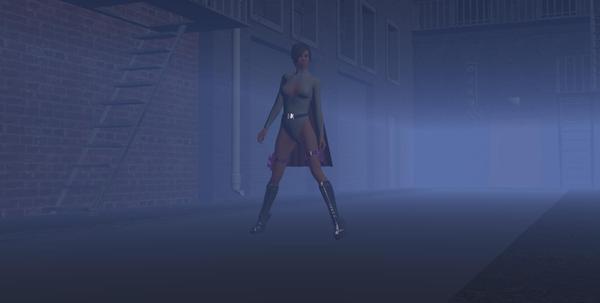

Can't tell you a lot as I'm a newbie to bryce and I haven't done a lot yet. However it is working with DS4.5 without a glitch for me. Seems everything is sent but I cannot verify it
Here's a complete scene I sent to bryce. Sorry for the render quality I'm not good yet
Bryce is a very interresting piece of software and I'll need some time before I can do anything good in it
*Edit : Scene is Genesis with basic morph and V4 autofitted costume
Nice atmospheric render. Sending to Bryce can be very worthwhile.
@Takeo.Kensei,
From your posted render, I can see that Genesis made it to Bryce, which is good news. Your render is great, with that foggy myserious atmosphere! Bryce can do that and more. I've been a fan of Bryce since version 4 but only got going with it a few years ago. There is always something to learn, and yet Bryce will give such satisfying renders right from the start. I hope you will find Bryce enjoyable for a long time and look forward to seeing more of your renders.
@Takeo: Looking at that image, I'm expecting to see a guy in a trench coat come walking down that street any minute. Or the bad guy whose about to get his clock cleaned. That's a very nice render.
Thank you guys. Bryce can do nice atmospheres and give some ambiance to a scene, plus better terrain, trees, water etc than DS. At the beginning I wanted to transfer from bryce to DS, but the renders are far from Bryce level this way. I'm only at the beginning of my (long) in Bryce
