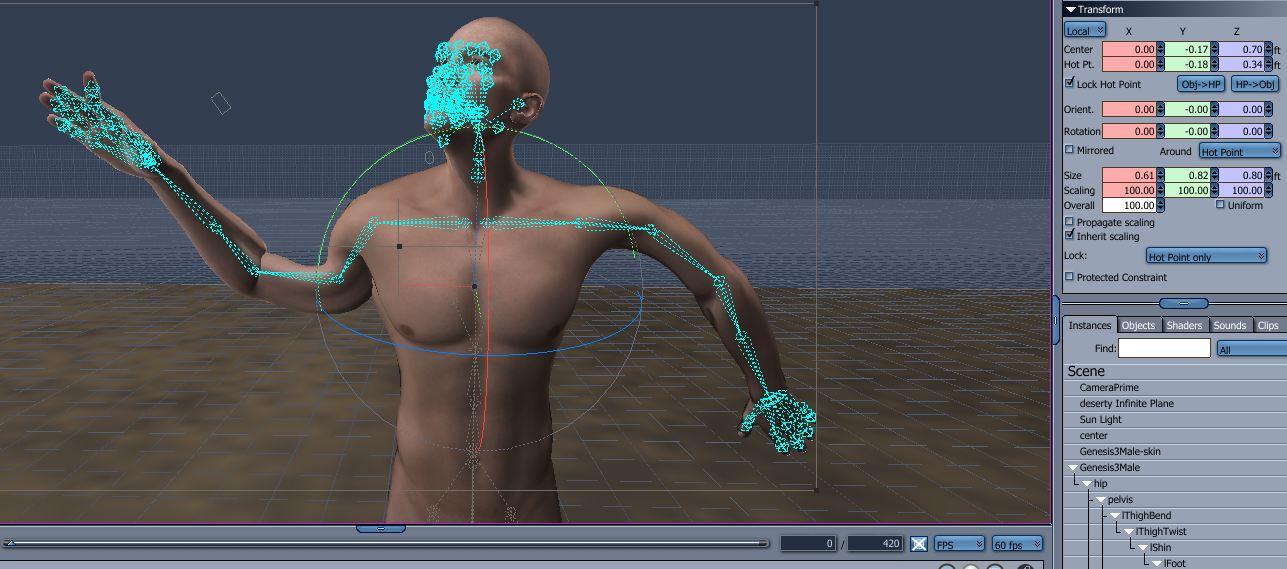

    colladaeded,  tee hee.  after this was able to resist Ryan7 with littl effort.
    put it on my DA art as, 'the Tortured Soul of Leo7'

    What do you mean? You got g3 over to C using collada?!!!
  • WendyLuvsCatzWendyLuvsCatz Posts: 41,749
    Yes she did but she dislocated the poor buggers joints crying

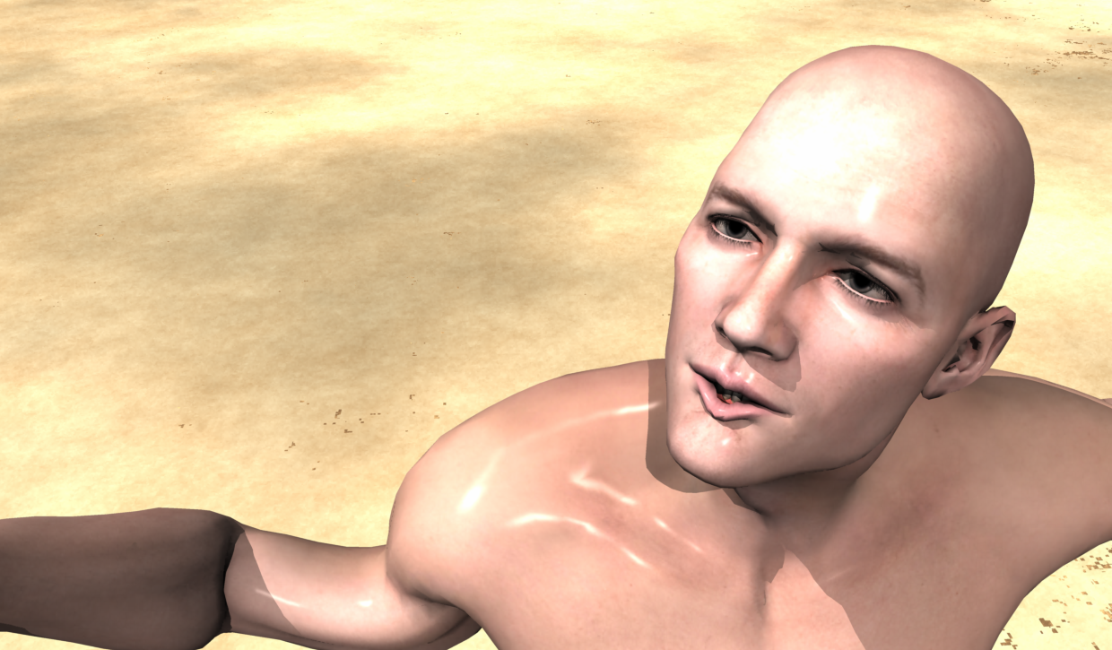

    a very,very base rubbery figure. but the lip bones work.  mebbe with limits setup? dunno if worth the effort.
    memories of playing with stretch armstrong doll.  lol
    exported Leo7 as ds collada from ds4.8.
    his eyes rotate
    Post edited by Mistara on
