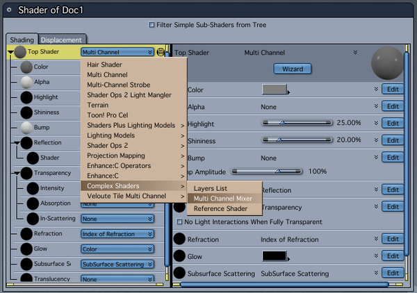

    It has been suggested that SSS maps can be used in Carrara via MULTI SHADER MIXERS. This is two complex shaders that are blended with a mixer channel. SSS map goes in the mixer, and your two shaders are identical except one has SSS turned up and the other doesn't. (see pic)
    I haven't tried it myself because I don't really like the look of SSS, it cancels out too much of my skin surface detail, and I'm pretty good with shaders so if I want a specific translucent look I can fake it very well in the glow channel where I can control it 100% without changing my light rig.
    660 x 464 - 121K

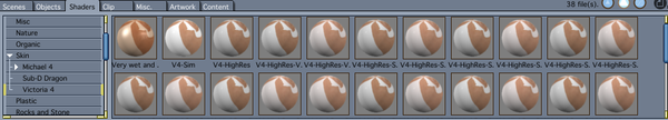

    So you're aware, Carrara Pro comes with some high res. skin shaders for M4 and V4. Some even use the SSS channel. You can find them in the Shader Browser. The ones that use SSS have GI (Global Illumination) at the end of the file name.
    To use them, select the model from the figure's hierarchy in the instances pane, then select the Shading tab at the top of the screen and drag shader icon from the Browser and drop it on the multi-colored ball at the top of the screen above the list of shading domains. Let Carrara chug away for a minute or two, and viola! All the domains are changed!
    The SSS shaders will look better with Indirect Lighting enabled in the render room. It will take longer to render as well. It's also a good idea to remove any unused master shaders to save on system overhead.
    248 x 268 - 32K

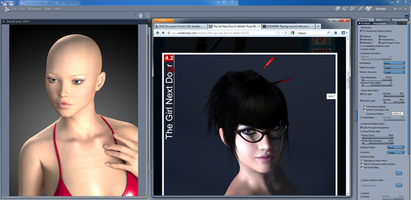

    This is the best I can do, since I have not read any manual or have no photography skills, there should be a lot of room for improvement.
    Scene used: http://www.sharecg.com/v/28074/gallery/7/Material-and-Shader/V4-Skin-Shader-kit-and-Lights-for-Carrara-6
    Character: V4 Delphinia, using the Carrara 8 V4 hires Candy GI shader and Basicwear for V4
    Software: Carrara 8.1
    Render target: GND4:Athletic at http://www.renderosity.com/mod/bcs/the-girl-next-door-4-athletic/63124
    1914 x 932 - 1M

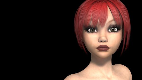

    I am not sure how to post an image let me see if this works.
    Both have SSS. One have a red color SSS and the other an aqua/cyan color.
    1280 x 720 - 103K
    1280 x 720 - 103K
