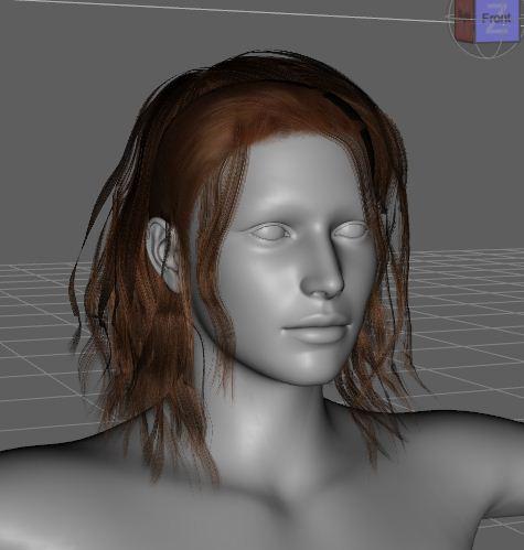

    Ok I just tested Mark hair using the conversion and it worked no problem, fits just right and the materials apply fine.
    Try again and make sure that you start with a plain Genesis figure, no morphs or shapes and do not move the hair when you load it. Then follow the steps in the tutorial exactly.
    The image below is the converted hair with material applied
    nicci... :)

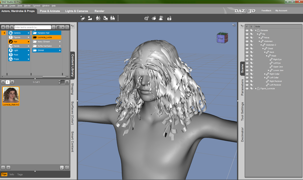

    @ niccipb : I show you a picture of what I get when I follow the tutorial. The hair is not well positionned and I can't attribute any Material.
    1662 x 991 - 470K
  • niccipbniccipb Posts: 483
    Hi...
    Sorry for the late reply...
    I can see now why this is not working for you.... your using DS 4.0, the 'convert prop to figure' had some bugs and non-working functions in 4.0
    The tutorial will work in version 4.5 as they fixed those issues.
    If you don't want to upgrade at this time then what you will need to do is load the hair prop and parent it to Genesis head then dial in or apply your character shape. Then in the parameters pane use the translation and scale sliders to adjust the fit manually. You should also be able to apply a material preset then (that was another of the bugs with the 'convert prop' function in 4.0)
