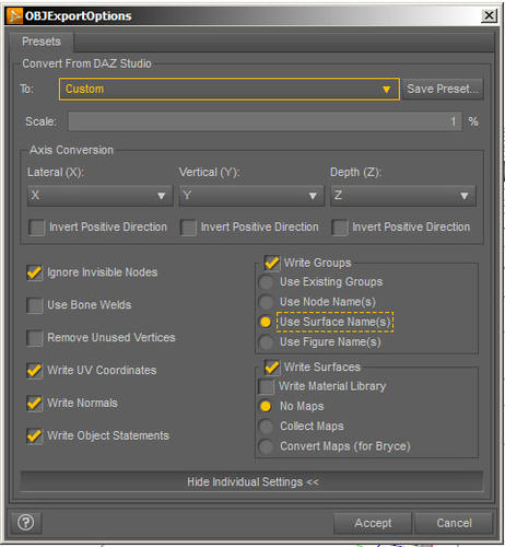

    I just tried to load my V4.2 model into Maxwell and it's blank ? All of her parts are listed in the objects tab. But she is gone ,I don't understand....
  • Half LifeHalf Life Posts: 479
    How did you export it from DAZ? The only method I've found that works correctly is OBJ -- FBX would be better but Maxwell Studio has some real problems with that format for some reason.
    See the attached image for the details of how I set my OBJ export.
