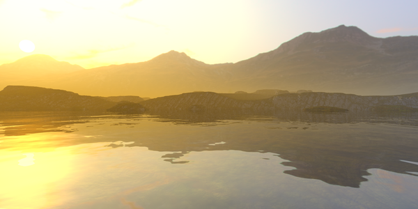

    Okay here is another result of completing a tutorial, in this case the tutorial followed was:
    Bryce lake in a landscape - a 15 minute tutorial by David Brinnen
    Now this one I have also already shown to David for review in a different thread. This one however I was unable to use the exact same HDRI as I didn't own the approriate set at the time. There was however a reduce resolution version of the same HDRI that came with Bryce. The first image below is the one made with that reduced resolution version. Because the resolution was reduced I sought to offset that somewhat by turning up the quality setting for the HDRI to 256. Now however I have since bought the necessary pack containing the proper HDRI and so I decided to do it again with the Hi Resolution version used in the video and since I was doing that I turned the quality back down to 16. The result is the second picture. Now that I'm able to compare the two the increased quality settings seemed to just make the sunlight seem brighter and so even though the quality is lower I like the second one better. Other then that though I'm not seeing much of a difference. So either the quality settings did make up for the resolution or the resolution wasn't as much of a factor in the result as I thought.
    A final note, in the video you're encouraged to not try to save the file with the maximum size HDRI as it will likely cause Bryce to crash. So the advice is to switch out a lower resolution for the higher one, when you want to create an image. No warnings were given though that it would turn off the haze when you did that so at first I thought it was a resulte of the different HDRI requiring me to reposition the terrain. Fortunately before too long it dawn on me what changed was that the haze was gone. Now the video did encourage you to recheck the add to sky setting as that also gets turned off but in the future maybe it's a good idea to advise viewers to recheck all their skylab settings?
    800 x 400 - 276K
    800 x 400 - 248K

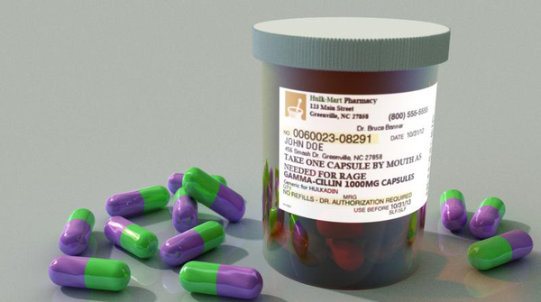

    Okay here's yet another one that was already done previously but with a lower resolution HDRI then the one used in the tutorial. It too was able to be updated to the appropriate HDRI after my latest purchases. Here is the link to the tutorial it was based on:
    Bryce still life project - "capsules" - a 15 minute tutorial by David Brinnen
    In this case I'm less pleased with the updated version but only because when I changed the HDRI it redisabled the sun and I didn't notice it but with the sun disabled it totally killed the anisotropic effect. (this is what happens when you start a render just before going to bed) Unfortunately for me and my computer this render takes about 8 hours so all I can show right now is the original and the updated one where I forgot to turn the sun back on. Sometime later today though I should be able to post how it should look. For now though the first one is the original and the second one is the updated one with the sun accidentally left off.
    Also one note for anyone interested in following this tutorial. I improvised the pill bottle on my own and as such that is not part of this tutorial. The tutorial when followed will only result in a pile of pills on a flat surface.
    800 x 446 - 562K
    800 x 446 - 535K
  • David BrinnenDavid Brinnen Posts: 3,136
    You are correct about the haze, it takes a fresh set of eyes sometimes to see what it right in front of us. To me it is an unhelpful automation, I'd prefer it if I could load a HDRI and not have settings changed for me. But well... I will try and remember in future to raise this point.
    Your other observation is also very interesting in that it gives a good example of the difference between the image of the HDRI you see in the render and the light supplied from that image. A low or high resolution version of the same HDRI should provide a very similar sort of light but... much depends on the size of the light sources.
    The quality control determines the number of simulated light sources in your scene. A procedure (algorithm) determines where these light sources appear in the sky, their colour and intensity is determined by the HDRI. So if you set the quality to 16 then 16 virtual suns appear in the sky and the algorithm should make sure they are distributed in such a way as to take account of any major light sources - like the real sun in your HDRI - for example.
    Of course 16 suns to simulate a backdrop of thousands of pixels is not very many. So as you modify the quality these simulated lights shuffle around a bit to make room for one another, the intensities change accordingly and as a result the light changes. The practical upshot of which is that changing the quality setting can alter the overall brightness of the light and also, changes in HDRI resolution, even though the virtual light positions have not moved, can change the light because the pixel it is getting the information from has changed. (this effect can also be seen when rotating a HDRI backdrop and using low quality settings - the light generated from the sources varies - sometimes dramatically)
    I don't think there is any averaging in the HDRI sampling to get the light information. Horo would know better. So what I suspect this means, is if a HDRI was made where alternate pixels were either as bright as the sun or fully black, then very slight changes in light position would probably cause radical changes in light output.
    As a backdrop, the difference between high resolution and low resolution HDRI is obvious. As is the memory footprint. One "trick" you could do, is set up your HDRI backdrop image as you want it. Strip out everything in your scene. Spherical map the the HDRI backdrop along with or without sky effects (depends on your scene). Then light your scene with a low resolution HDRI and put in a giant sphere on which you put your captured spherical map. This will save a lot of memory.
    You may not be so happy with your second pills render - but it serves as an excellent example of the difference that providing a key light source makes to the overall impression the render gives. If anything I'd say the second render looked more realistic in terms of overall lighting, all be it a little dull - that could be corrected, just as a photographer would do using some software.

    Okay now that enough time has passed I have finally in my posession a properly lit copy of the capsules scene using the highest resolution of the HDRI recommended in the tutorial so we can now compare the lo res HDRI to the Hi res. The first one is the lower resolution one the second obviously is the higher resolution one. I see virtually no difference so my conclusion is that in this scene the resolution of the HDRI made no real difference.
    800 x 446 - 266K
    800 x 446 - 535K
    Agreed but not surprising. A reflective surface would have to be very large to show up the weaknesses in a lower resolution HDRI. If for example, the ground plane were made reflective, then because it is flat, that would show the difference at once. Two reasons why I avoided this, the first being that still life use narrower FOV than landscapes so then even a high resolution HDRI would be at the limit of displayability and second, mixing reflection and TA ramps the render time up quite a bit.
