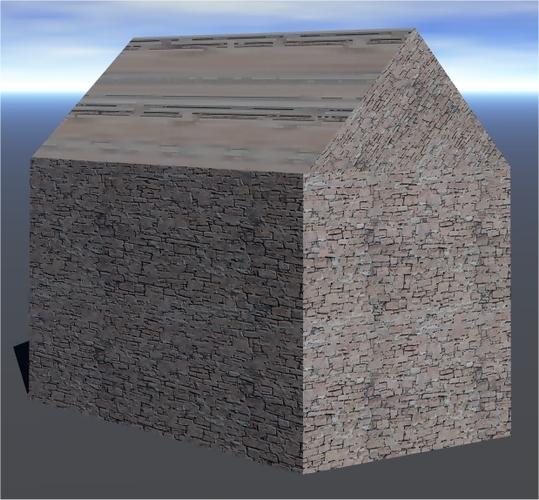

I have attached a picture of two blocks both made using the STONE10M texture that came with Bryce.
Now when I look at the TIF file in a viewer it looks just what I want.
In Block 1 to the left you can see it applied in it's natural form.
I copied the block and went into (M)aterials then into the (T)transformation button and rescaled the materials bu -21 for xyz respectively (top icon)
I copied the image from the left box into the centre box (I'm sure this is the BUMP)
I then applied a 10% bump to the block and ticked.
This is the result.
Now I want two things...
The texture looks blurred despite having a bump - how can I clear this up?
The corner of the building looks too sharp for an old building - how can I rough this up a bit so it looks a bit more weathered.
Thanks in advance
2000 x 909 - 530K

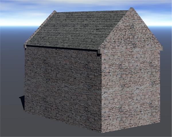

    I have created a 3 sided polygon and made it into the roof block.
    No matter what I do to rotate the materials in the texture transformation tool - I cannot get the stone on the gable end to rotate to the same as the wall beneath it.
    See Picture enclosed.
    619 x 574 - 243K

    Why bother trying though? The roof texture for a house like that should be something more along the lines of wood or thatch.
  • David BrinnenDavid Brinnen Posts: 3,136
    For that you need to comprehend mapping modes. There is a lot of scope in such a topic. If you use object based or parametric modes then the way the texture is applied will depend on the object not its position in space. If you use world space then your materials will align irrespective of the position of the objects. For example, as an experiment, switch all your mapping modes to world cubic.
    823 x 686 - 190K

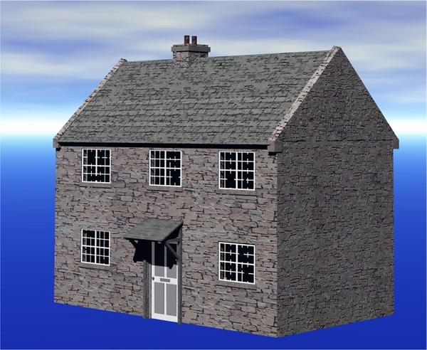

  • tdrdtdrd Posts: 0

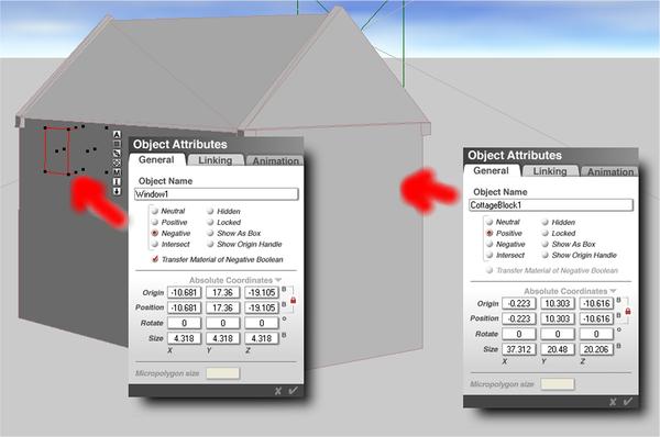

    Having loads of problems situating these vertical slats.
    I attach a pic to illustrate my problem.
    In the picture below the vertical slat to the right is too far forward and protruding from the frame.
    So I moved it backwards ONLY SLIGHTLY and it has disappeared.
    You can see the parameters in the picture and there is no way it is running behind the transparent box.
    So please can anyone shed any light on positioning the slat.
    I AM grouping the slat with the window pane and the window frame. placed on another negative box grouped with a positive wall.
    I've fiddled and faddled with this for four hours now and there is an increasing pile of hair falling onto my desk!
    I did not have much to start with!
    Please help.
    Thanks
    Terry
    2000 x 868 - 572K
    Slightly? The Z size is 0.700 and you move by 0.346 in the Z direction. That's half and quite a lot.

    Well I've only played with booleans a little so I don't know much about them. However I do fiddle with things quite a bit and depending on the scale of things in your scene a small adjustment can have a big impact or a little impact. I noticed in your picture that you changed one of the positions from .70 to .35 that can be quite a bit for something you're just trying to nudge into place a little better. I would have started with a change from .70 to .69 first, to see what impact a smaller move would make first and then adjust further once I have a feel for how much the small adjustment changes things.
  • Dave SavageDave Savage Posts: 2,433
    If you're dragging it into place, pressing the 'Option' key whilst dragging will move it in smaller increments.
    If you're using the number matrix in the Attributes, first select the horizontal window slat and make a note of it's 'Z' coordinates and set the vertical one the same.
  • LordHardDrivenLordHardDriven Posts: 937
    edited September 2012
    Another thought occurs to me, when the scene is done and rendered out chances are better then not that people looking at it will not be able to see that these slats stick out a little too far. So you may be pulling your hair out and spending alot of time on details most people might not even notice. Better to save the hair pulling, frustration inducing fixes for things people actually will notice.
    Post edited by LordHardDriven on

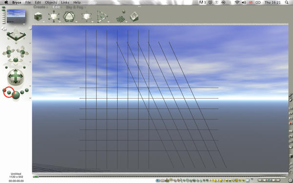

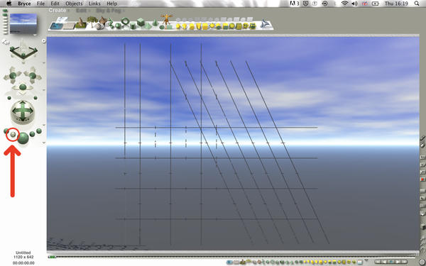

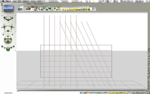

    When I am aligning elements when I am building something like this I will view the object from Top view, zoom in on the gorup and then move it using the keyboard arrow keys and Alt, which moves just a fraction at a time.
    So select one of the bars, change to camera view from top, use the plus sign at bottom left of your screen to magnify the part you are workin on to the best size for you and use the up.down.side arrows to manoeuvre it. remember it is Alt+arrow key to get tiny movements
    Post edited by Chohole on
    Just to elaborate on this a bit more. If you do as chohole is saying when you use the zoom in and out buttons it'll automatically adjust the top camera's position so the item highlighted is centered in the camera's view. Which is a good place to be when zooming in for adjustments. Being a 3D environment when you look at things from an angle and make adjustments you can have a parallax error which in terms of adjusting things in Bryce can mean from where you're looking things look like they're aligned properly but in other views you see they aren't. In wireframe mode this is even easier to have happen.
    I do notice however that sometimes the zoom feature doesn't seem to center on the selected object. I haven't tested it to confirm it but I suspect that happens when the object is part of a larger group. In which case the camera then is centering on the group associated with the selected object. In that case rather then ungrouping and regrouping you can use the little hand beneath the +/- to center the view.

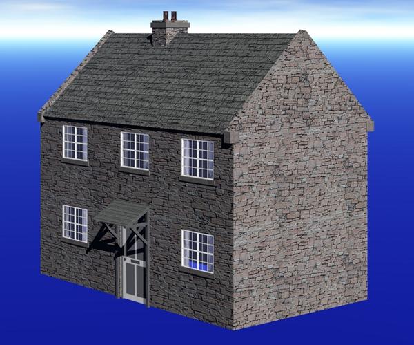

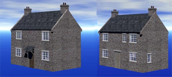

  • tdrdtdrd Posts: 0
    Thank you for all the feedback.
    I've been spending 15 hours a day fiddling around so getting used to the interface a bit now.
    I blew up the window object to 10x and managed to build up the window model.
    I saved that as a seperate file and grouped the bits and combinrd to object.
    The building has been duplicated and srunk to create cavity wall.
    I wish I knew how to give rooms a different light to rid the blackness but for what I need it does not matter I suppose.
    See what you think of the updated image?
    2000 x 1156 - 1M
  • HoroHoro Posts: 11,738
    I'd say you're on your way. Keep going.
    You seem to be doing very well, the cottage is looking good.
    For the light; You can place a light inside the building (lights are the yellow objects on the 'create' shelf.
    Though bear in mind that each light you add will also add to the render time as the application has to work out all the brightnesses... So probably better doing that once you have the finished cottage in your scene.

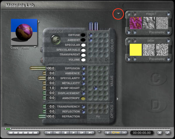

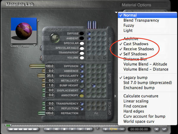

  • tdrdtdrd Posts: 0
    Yes it's coming on isn't it.
    I am a tad disappointed about the vertical slats disappearing with the shadows, but I am not about to change that this time with this effort.
    I wonder - is there a way to turn OFF the shadows of an object?
