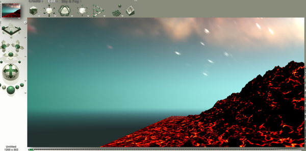

Okay ... basic Bryce 101
There's a tiny thumbnail in the upper left corner.
1. any way to make that larger?
2. There's a 'part' of the thumbnail that displays large on the screen. There's a "-" and "+" which will have either this enlarged part displaying OR the entire thing rather small in the centre of a huge gray space.
How to get the displayed image to be showing all what's in the thumbnail, filling the view pane?
thanks

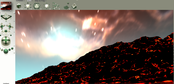

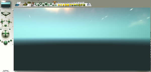

    2. No that's not it. It'll just render a partial view. I managed "once" to get it all right but forget what I did.
    I hope you see what I mean, there's more information in the thumbnails than the rendered image.
    795 x 392 - 171K
    792 x 382 - 189K
    796 x 384 - 87K
    In the file menu, click on "document setup". In the menu that appears, click on "max recommended" at the upper right. This will make Bryce enlarge your work window (and render size if you leave it the same) to make max use of your screen real estate. The preview thumbnail is fixed in size so will still show extra at top and bottom if you have a wide screen monitor.
    If you set your render size larger than the work window, you will only see part of the render as it happens. You can interrupt the render and reposition the view by holding down the space bar (cursor changes to a hand) and clicking-and-dragging to move the view around. Then click resume render. You can also use this panning technique to view the finished render.

    @TheSavage64 :-) thank you! And that's it!!!! thank you so much. I like to 'see' what I'm doing ... then I can resize the whole thing larger for rendering to print.
    @GussNemo I discovered there's also the toggle button for switching between last render and present state.
    If one zooms in, then renders, one gets a very different image rendered! It's like a magnified view or something.

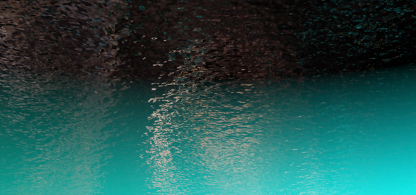

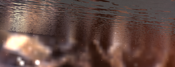

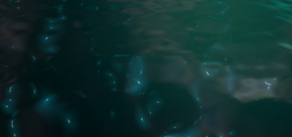

    Here's a few test images I rendered tonight ... Mixing the space set with some water was rather interesting for sure!
    792 x 372 - 97K
    792 x 306 - 277K
    792 x 372 - 409K
