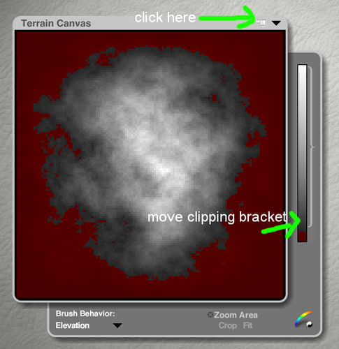

    When a mountain/terrain is created it has a square mat. This mat occasionally causes trouble because it can show up when you don't want it. Is there any way to feather it or make it a circle.
    Is this what you mean
    489 x 504 - 94K
