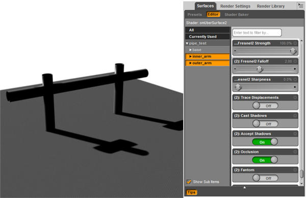

    You can also turn off shadows for a surface in US2 like in the test image below.
    nicci... :)

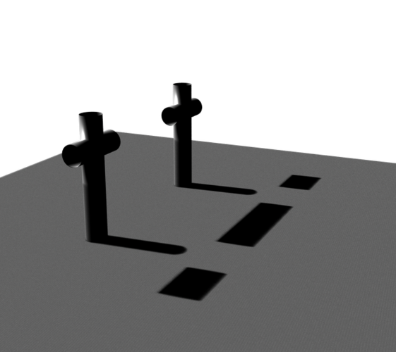

    If you are using Raytraced shadows on your lights, then it doesn't seem to work. It does work with Deep Shadow Maps though.
    I don't know if it is because the US2 shader needs to be recompiled for the current 3Delight render version or if it just doesn't work for Raytraced shadows at all.
    The image below has fantom on the cross bars and no shadows on the cross pipe using Deep Shadow Maps on a single Distant light using 4.5.0.137 Beta
    Hope this helps... :)

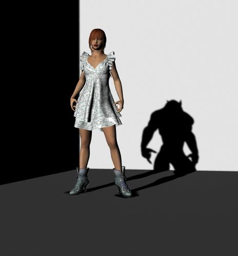

    I did wonder about using deep shadow map, but I tend to fight shy of that as I get a hug number of those annoying coloured #-shaped speckles when I do. I'll give it a whirl and see what I can come up with.
    And thank you!
  • SimonJMSimonJM Posts: 6,108
    edited September 2012
    It does indeed work with deep shadow maps ... here is a first cut at the sort of thing I was after - no postwork done.
    (and now with added file!!!!)
