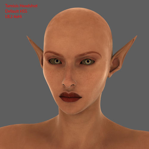

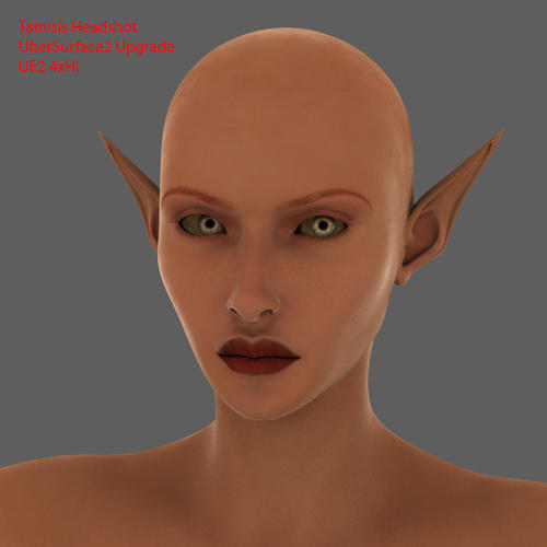

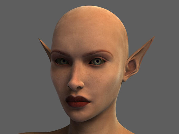

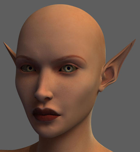

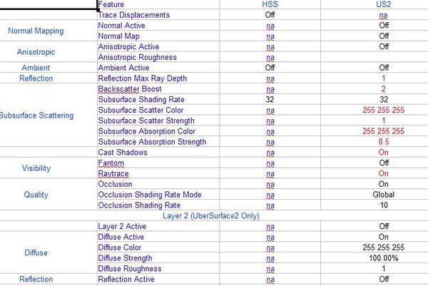

    Well Szark, after playing with your settings I arrived at what you see below. Basically it's exactly the same as the previous spreadsheet but with the modifications you suggested. It's still not the same as the HSS but it's definatly better. I see some of the detail returning. With more playing I'm sure I could get it much better, however the question still remains as to why it's so much work to get decent results in what should be a better shader.
    There is a halo that has appeared around the lips that I'm not sure where it came from. There's also something strange going on with the scelera, but the scelara issue was there before. I wasn't really worried about that at this point as my main concern has been the loss of detail in the skin. The other thing about the skin is that it looks like she is wearing too much foundation (makeup.) I don't know if it is what is obscuring the texture but it is a side effect that in itself could be reduced if I could figure out what is causing it.
