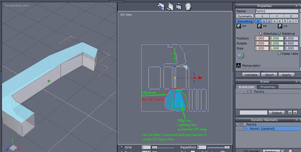

I am having a problem with this 3d model I have made
I have an extra flap or bit on the UV map.
Whats happaning when ever I create 3d models like this in hexagon using the creat facet
tool under 3D Primitives I get an extra part that I dont need as shown in the image below and attached
1078 x 547 - 286K
    Can someone people or someone help me out and tell me what im doing wrong
    1078 x 547 - 286K
    1078 x 547 - 286K

    Just out of curiosity, what does the UV display look like if you select the face on the bottom?

  • hawker2000hawker2000 Posts: 0
    the UV map on the other side looks exactly the same I get the bit I dont want if I select that side its a bit hard to explain
  • AscaniaAscania Posts: 1,856
    Clean up your top face. If you don't create concave n-gons you won't have this trouble.
    How do I clean up the top face. very new to this 3d modeling stuff
    Cut it into quads.
  • RoygeeRoygee Posts: 2,247
    The top face probably isn't connected to the sides?
    Looks like the easiest way for you to fix is to delete that whole top face then bridge opposing edges of the side faces.
