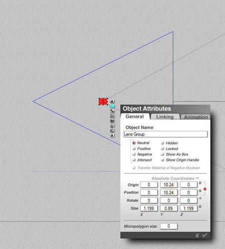

    Looks like I need the spherical mapper aswell to get a full spherical image. I tried playing in carrara with the camera inside a sphere with refraction settings but no sucess in getting a simulated shift of the render for left and right, You use the bump map channel as well in Bryce but I can'y get anything similar in carrara?
  • David BrinnenDavid Brinnen Posts: 3,136

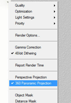

    This was tricky to set up and relies on being able to get a specific bump effect. This only works because bump is virtual geometry not real geometry. The geometry that it is simulating is not physically possible. Imagine that it is like a single Escher step on edge arranged around a cylinder, forever rising, but never getting anywhere. Or if you prefer an infinite number of infinitesimal steps. Same effect, but either way, no joins, just a perpetual shift. Someone sufficiently versed in Carrara may be able to match what has been done, it depends one how Carrara bump works, if Carrara has some equivalent optical properties to use and if an appropriate procedural function can be called upon to achieve this. That's a lot of ifs. Too many for me to confidently say it is possible.
    If I had to start from scratch to recreate these lenses in Bryce, even with the knowledge of how they are done, I think it would still take several weeks of work to get them correctly calibrated. The settings are finely adjusted.
    Yes, to get a full spherical image you would need a spherical mapper. Bryce's panoramic render is cylindrical not spherical.

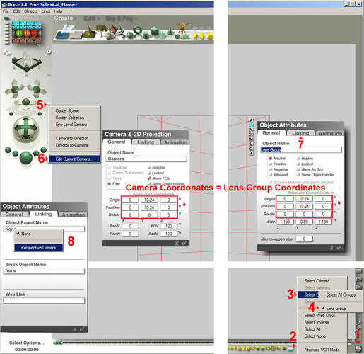

  • GSSEVGSSEV Posts: 32
    I tried a lot of combinations in Carrara with no real success. I did get some lens effects but Carrara doesn't seem to change the normal the way Bryce does. I'll leave it for now , something might appear in the future. I had success with a rotating camera pair taking 240 thin strips each which I joined in stereophotomaker to get good spherical stereo pairs.
    So I have a solution for Carrara for still images thats quite easy, I can use Bryce for animation and stills now I have the spherical mapper and true 3d files,
    I bought a copy of Messiah studio when they did a promo with a very low cost and now have version 6pro after a similar upgrade and I just found it has a native stereoscopic panorama camera so now I'm spoiled for choice. So thanks for the help with Bryce and hopefully I'll have some nice 3d panoramas soon.

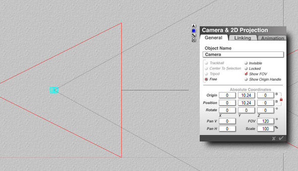

  • CTippettsCTippetts Posts: 162

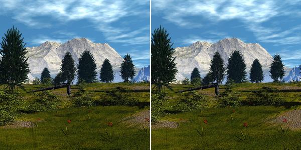

    This is how I like to do a stereo image. It's like they used to do way back at the turn of the 20th century. I've used this method with a real camera, to duplicate the process of using a tripod to make stereo landscape images of Yellowstone and Dead Horse Canyon ... moving the camera over just a bit for the second shot.
    Later a game called Halo came out. It had a mode called "theater", where you could replay games you participated in, to watch yourself fail or pwn. Halo gave full control of the camera, so you could watch the game from other points of view than the one you played in. It allowed you to take snapshots, or even short videos of the game play. I used that in the same method as with a real camera on a tripod to make stunning stereo images of explosions and such from my game play.
    So I thought I'd give it a go using Bryce. Below is my first attempt. The specifics are, I created the scene, then changed the ratio of the document to square. I did an image export, then moved the camera over to the left 5BU, and did another render and export. I put the two images into Paint Shop Pro, putting the first image on the left, and the second one on the right. I added a thin, white bar to separate the two images to make the below viewing method easier.
    To view this, look at the white bar at about where the highest mountain is. Cross your eyes, so the white bar becomes two white bars. Keep crossing your eyes until the two images become three images of about the same size. You'll notice the two mountains becoming one in the middle image. The 3D effect should pop out at you then in that middle image.
    Unfortunately, this is very difficult for people with vastly different eyesight in their two eyes, and, of course, impossible for one-eyed people. My eyes are off from each other by almost two diopters, but I can still do it. Um, seeing the 3D effect is also something that the brain does, so people with slow brains or brain injuries have trouble, too. Please don't send me hate mail if you can't see the effect.
    1395 x 695 - 338K

    @CTippetts - nice. I can't make it work, I'm probably a bit out of the habit. I have an apparatus for parallel viewing (I did a lot of stereo prints many years ago, also from Bryce renders) and this lens gives me some 3D effect but obviously, viewing parallel for cross eyed doesn't work correctly.
    I'm pretty sure, for you to use it in your "parallel viewing apparatus", (which were commercially produced as Stereo-Scopes, and were where my original inspiration came from years ago with a real camera), I need to swap the images, so that the image that was taken rightmost is on the right side of the image and the other accordingly. This one, for the "crossed-eye" method, has them swapped. I'll try to get that done for you, and post it here ... assuming you can print it in the right size for the apparatus.
    I feel like this is the first, and I will be doing more in the future. Kinda' fun. In the future, I'll post both versions.

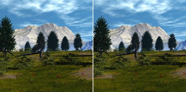

    CTippetts said:
    I'm pretty sure, for you to use it in your "parallel viewing apparatus", ... , I need to swap the images... I'll try to get that done for you, and post it here ... assuming you can print it in the right size for the apparatus.
    Try this one with your StereoScope.
    (Up in the night with a BAD tooth ache.)
    1395 x 695 - 338K
  • HoroHoro Posts: 11,717
    Yup, this works for me, thank you. I have a Loreo stereo camera I used a lot but without films, it's redundant now. The viewer is quite nice, I have to disassemble it to view stereo on screen.
